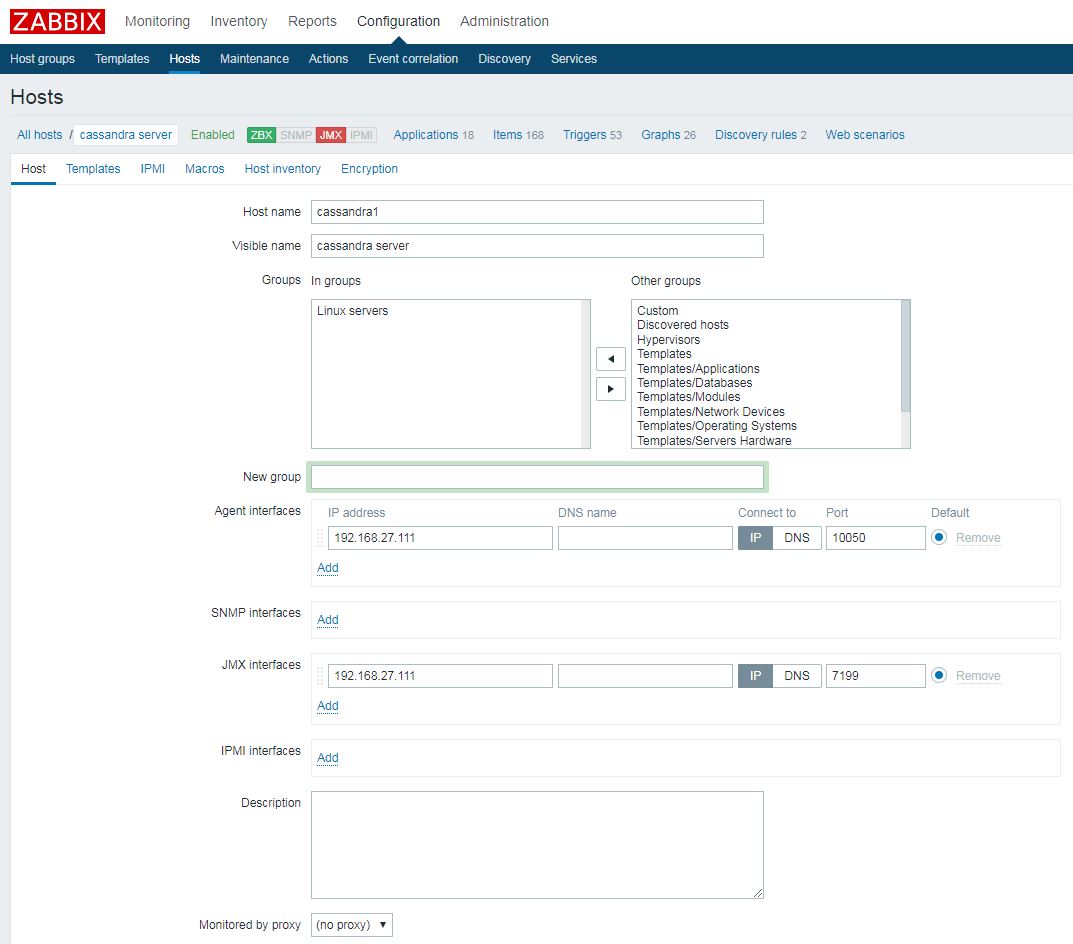

        • sriramkumar
          • Mar 2018
          Now i got following error (After modify your suggestion @joshuamcdo):
          java.io.IOException: Failed to retrieve RMIServer stub: javax.naming.ServiceUnavailableException [Root exception is java.rmi.ConnectException: Connection refused to host: 192.168.27.111; nested exception is:
          java.net.ConnectException: Connection refused].
          Please suggest me where i missed or make a mistake
          My current Configurations below:
          Zabbix server,Java gateway both installed in same machine- 192.168.27.13
          Cassandra server installed on -192.168.27.111

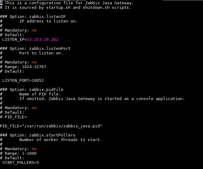

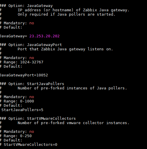

            I am having a similar issue quoted above for JMX monitoring .
            My zabbix server and java gateway is on different server.
            Please find the configurations performed.
            Captured with Lightshot
