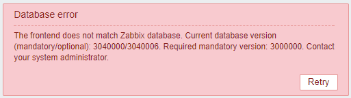

    I upgraded zabbix and zabbix works but the frontend fails.
    I have a pink box with this message:
    Database error
    The frontend does not match Zabbix database. Current database version (mandatory/optional): 3040000/3040006. Required mandatory version: 3000000. Contact your system administrator.
    When upgrading I found this in the log:
    7114:20180129:092754.144 completed 94% of database upgrade
    7114:20180129:092754.156 completed 95% of database upgrade
    7114:20180129:092754.168 completed 96% of database upgrade
    7114:20180129:092754.180 completed 97% of database upgrade
    7114:20180129:092754.197 completed 98% of database upgrade
    7114:20180129:092754.392 completed 99% of database upgrade
    7114:20180129:092754.548 completed 100% of database upgrade
    7114:20180129:092754.548 database upgrade fully completed
    7114:20180129:092754.903 server #0 started [main process]
    7129:20180129:092754.904 server #1 started [configuration syncer #1]
    7130:20180129:092754.904 server #2 started [alerter #1]
    7131:20180129:092754.905 server #3 started [alerter #2]
    7132:20180129:092754.905 server #4 started [alerter #3]
    So the database was upgraded succesfully but still I get the message.

    Everything SEEMS ok but it isn't....
    I checked all the config files, everything is/looks ok and as you see there are no other errors.
    Required database version is the same and still I have that error....
    Somebody can help with this or knows more?
    thanks.
    problem is fixed, I forgot to copy the new frontend directory.
    After I copied the frontend directory, I could start the wizard.
    Now I can login and everything seems ok.
