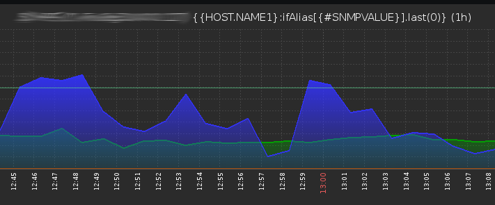

    Hello, I can't get the Graph name to show the ifAlias interface description. I search the forum and tried solutions like the on in this post with no luck.
    The item prototype:
    SNMP OID: IF-MIB::ifAlias.{#SNMPINDEX}
    Key: ifAlias[{#SNMPVALUE}]
    I tried the without succes with:
    {#SNMPVALUE} {{HOST.NAME}:ifAlias[{#SNMPINDEX}].last(0)}
    {#SNMPVALUE} {{HOST.NAME}:ifAlias.[{#SNMPINDEX}].last(0)}
    {#SNMPVALUE} {{HOST.NAME1}:ifAlias[{#SNMPINDEX}].last(0)}
    {#SNMPVALUE} {{HOST.NAME1}:ifAlias.[{#SNMPINDEX}].last(0)}
    {#SNMPVALUE} {{HOST.NAME}:ifAlias[{#SNMPVALUE}].last(0)}
    {#SNMPVALUE} {{HOST.NAME}:ifAlias.[{#SNMPVALUE}].last(0)}
    {#SNMPVALUE} {{HOST.NAME1}:ifAlias[{#SNMPVALUE}].last(0)}
    {#SNMPVALUE} {{HOST.NAME1}:ifAlias.[{#SNMPVALUE}].last(0)}
    But with {HOST.HOST} instead of {HOST.NAME} it gives *UNKNOWN*.
