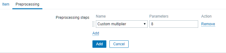

    In 3.4, that moved to the preprocessing tab of the item. (At least 3.4 is the first place I noticed it, we jumped from 2.4)

      Ok, and how can i configure this preprocessing tab to have bits ?

        just add multiplier 8 (see screenshot)

          Thanks, i found it
