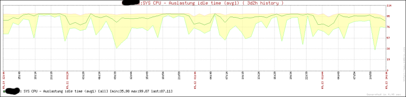

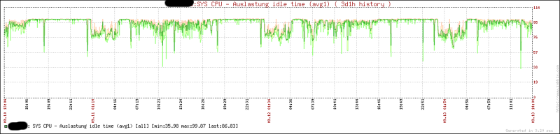

                I got another question.
                When i show the history of an element and the period is more then 3 days then the trendvalues are used.
                If the period is less then 3 days the history values are used.
                Is this right? That woul mean that the limit isn't 24h, but 73h.
                I'm using Zabbix 1.4.2.
                  When you want watch history values on a given time period, ZABBIX will show you values's history table matching in this time period (1 value for each interval monitor time) and it will try to complete data from the trends table (1 average hourly value) for those values that are no longer available in the history table.
