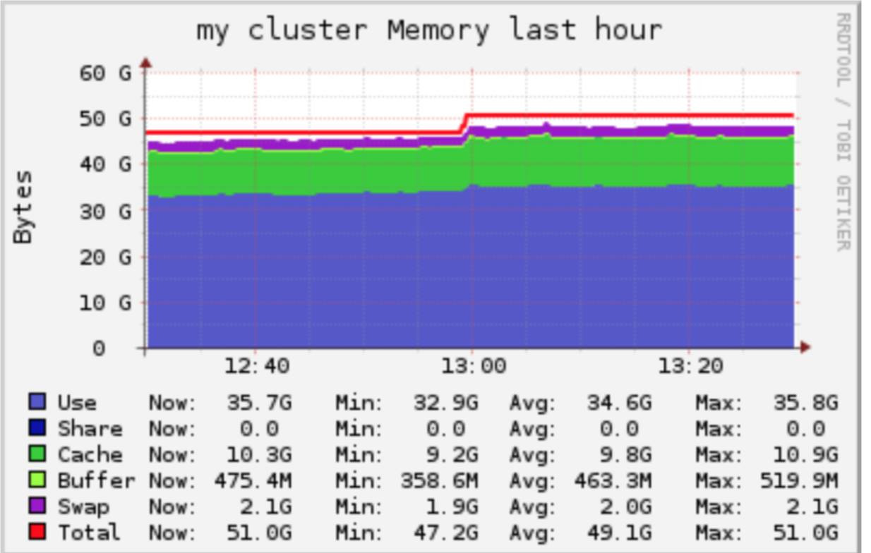

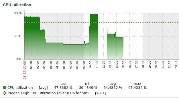

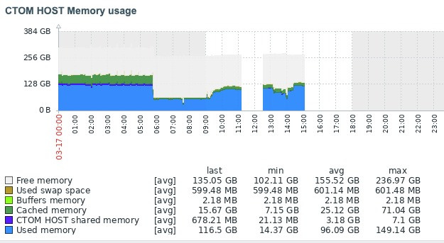

        UP, I manage a compute cluster for scientist. Previously we used Ganglia but this software doesn't work anymore (not updated). So I use zabbix : I would like to display a single line in a stacked graph, precisely on the attached picture memory usage graph: I would like to add a red line for the total memory (same it can be done with ganglia ) ; but I understood that we could not do it in Zabbix, unless you have an idea to do it inside Zabbix graph (but I dont want do it with grafana). I think I can do it it with a trigger like the attached picture of the CPU usage graph : this one is included in a zabbix template: you can see the trigger line on the CPU limit. But unfortunately by consulting the documentation and the CPU trigger already present in Zabbix, I don't understand how to attach a trigger to a graph via an item: I created a trigger of the total memory (total memory types> total memory) and checked "show triggers" in the graph configuration ; but it is not enough : the graph does not display the trigger as you can see in the attached picture. Can you help me ? thanks in advance
