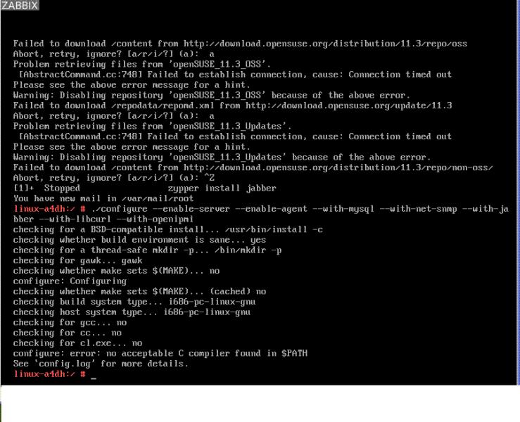

                            error line configure server
                            Hi
                            Zabbix installed with Virtual Box on Live Installer
                            #./configure --with-pgsql --with-ldap --enable-server --enable-agent --with-jabber --with-net-snmp --with-libcurl --with-openipmi
                            why this line does not work?
