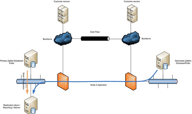

                • qix
                  • Oct 2006
                  • 423
                  Thanks for the reply all.
                  I'm afraid i cannot use virtual ip's because the subnets on each location are different.
                  What I have conceived is the following setup (see attached picture).
                  The Primary server is node 1, the secondary server is node 2. So this is a distributed setup.
                  I will use a third server where my databases are being replicated to (master-slave).
                  This will allow me to make backups of our (large) databases (+40GB / 2.5GB compressed) without database locks on the zabbix servers.
                  Secondly, this also allows me to schedule detailed reports generated from the zabbix database without performance loss on the monitoring servers.
                  Thirdly, when the s*** hits the fan, I can always use the reporting server as a spare zabbix server in case of failures, the database is already there, so it should be easy to get it up and running.
                  So failover isn't automatic, but that doesn't really matter at this point.
                  If the need arrises, maybe we will go to 4 servers so there is a spare zabbix server on each site, then automatic failover could be achieved. (I'm thinking VMware here )
