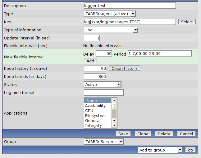

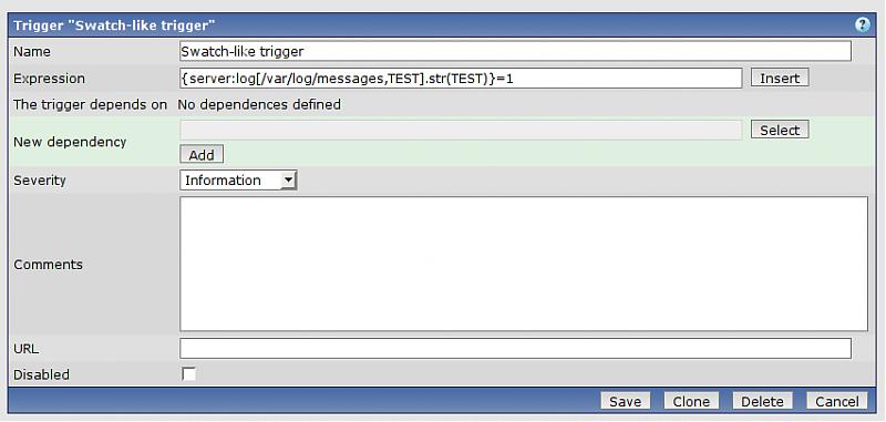

    Does Zabbix have the same functionality as the UNIX utility called Swatch (i.e alerting us everytime a regular expression match is made in a text file)? I've read several post and the documentation about monitoring log files, all very helpful, but just can't get it to work. More specifically, watching for the regular expression "TEST" in /var/log/messages. I've setup the Item, Trigger and test by running "logger TEST" which adds a line to syslog like:
    Mar 10 13:33:32 server root: TEST
    Permissions on /var/log/messages have been changed to be world-readable so the zabbix user can read it but the fact remains, I'm never alerted when "TEST" appears in the log.
    Thank You,
    -ptader

    The Key posted above is:
    log[/var/log/messages,TEST]
    The Expression is:
    {server:log[/var/log/messages,TEST].str(TEST)}=1
    That string will never evaluate into a trigger and even if it does, it will not turn off.
    My Key is the same but my Expression is
    {server:log[/var/log/messages,TEST].nodata(0)}#1
    That expression says something along the lines of "I got a bit of data and have not gotten anything else for at least 1 second" and it becomes True and then will turn False again right away.
    If someone knows a better way of doing this, please post. I have dozens of expressions on dozens of computers so if there is a better way that works just as good as this does, I would like to use it.

      This is good information. The systems that I want to monitor are not expected to generate a lot of log messages. Even if there was a spike in traffic (say an app or process dumps 20 - 30 lines into the log all at once) waiting a minute for the alert wouldn't be disasterous considering what were looking for.
      That said I'd like to use Zabbix's log monitoring functions, but I just can't get it to work. Referencing the screen shot below, if I send 'TEST' to the log I'm never alerted by the trigger that it found the regular expression. Can you see anything misconfigured?

              I use the:
              {Host:Trigger.nodata(0)}#1
              to turn off the trigger. The downside is that multiple messages may come in at once time and you will only get one message. I have been unable to find a better method and no one has suggested better yet (I have like 3 other posts asking for better methods).
