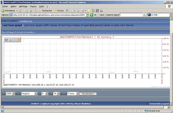

              • zebulon
                I have the same problem
                I have just upgraded to alhpa 1.11 and i have add a new machine with 2 items generated by a perfcounter of my network card all data are recorded but I can't see nothing on my graphs.
                if I see a graph who have created before installation of last version of zabbix graphs works correctly.
                have you an idea ?

                    • zebulon
                      All my tables are in Innodb, and my version of MySQL is 4.1.12 on debian server.
                      You can see an example of my graph.I see only some parts of my curve,but if I see data values I have all values on database.
                      if you need more details, talk to me what you want and I give all information to solve this problem.
                      thank you.
