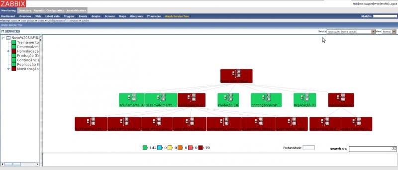

    Hi, my name is Felipe . I work in the IT Services monitoring project. We developed a patch to Zabbix using Prefuse (a Java library for information visualization) to view the IT services tree created in Zabbix.

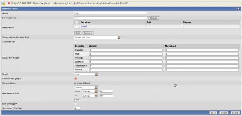

    For status propagation from lower branches towards the root of the tree we created a weight and threshold algorithm for each service. In our implementation, each service have a weight for each status it may assume, and a service status is given by comparing the thresholds (also, one value for each status) to the sum of the weight of all its children, so, if the total weight is greater than an specific threshold, the service assume the associated status, and the parent node is re-calculated (thus, propagating).

      services_form.php → addition of fields for weight and threshold

      arvore_grafica.php→ contains the graph tree
      graph_tree_xml→ load of the tree in an xml format
      dbconfig → bd adjusts settings for the graph tree

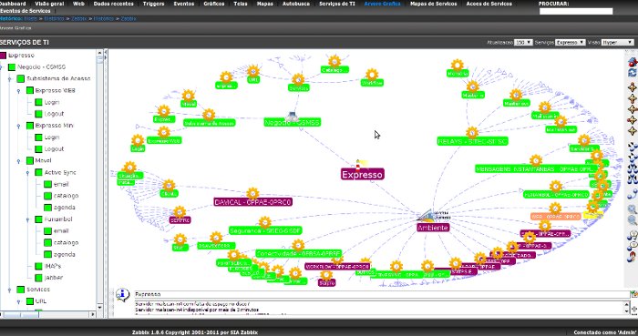

                  New Implementations
                  Hi everyone,
                  I posted in https://sourceforge.net/projects/graphtree/ new version of my implementation.
                  I included new view called Hyper View:
