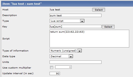

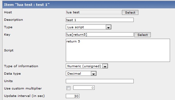

So what does this patch do? It allows you to create your own Lua scripts and run them as a normal item. Right now there are only two functions available in the lua script engine, getitem(itemid) (returns val,clock in that order) and zabbix_log(level,message).
Configuring is pretty straight forward as a new item item is added called "Lua Script" (type 16 for those interested). The key just needs to be in the format of lua[unique identifier]. Also it is important that your lua script return a value using the "return" statement.
In addition you can also set up your own lua library. Just point the zabbix_server.conf variable to where you want to load your library for example:
LuaScriptLibrary=/etc/zabbix/lua/zabbix.lua
There is also a configuration option to start more Lua Pollers using
StartLUAPollers, the default value is 1.
In the following example I have created a lua library with the following:
function sum(...)
total=0
for i=1,#arg do
total = total + get_item(arg[i])
end
return total
end
If you have suggestions for the next patch release let me know.
