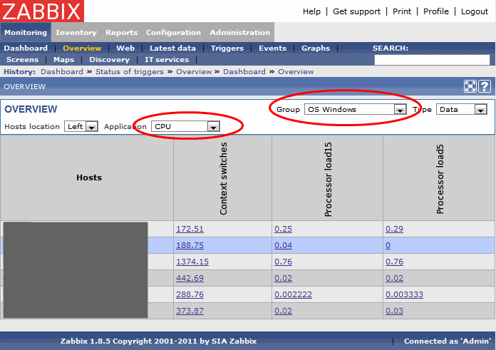

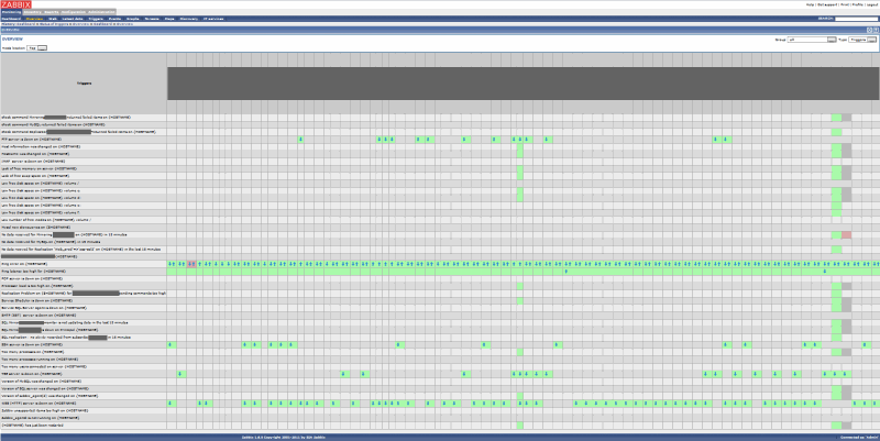

    Do you remember when you started using zabbix, and the overview screen was nice and clean with all the relevant info for your 2 test servers ?
    Are you , like me, adding more and mode items, triggers and hosts ?
    Your overview is getting bigger and completely unuseable.
    Maybe you'd like get back a useful overview again...

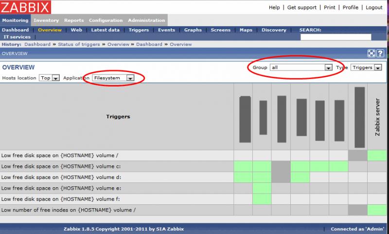

    Here is my small contribution .
    This patch is made against 1.8.5 it adds the ability to filter by application the overview page for data and triggers, and works at the screens level.
    Known limitations :
    * there is no '- other -' application filter for items and triger with no application. you have to pick 'all' applicaitons to be able to see those...
    * this has only been tested on my setup .
    * This is as usual provided 'as is'
    enjoy ...

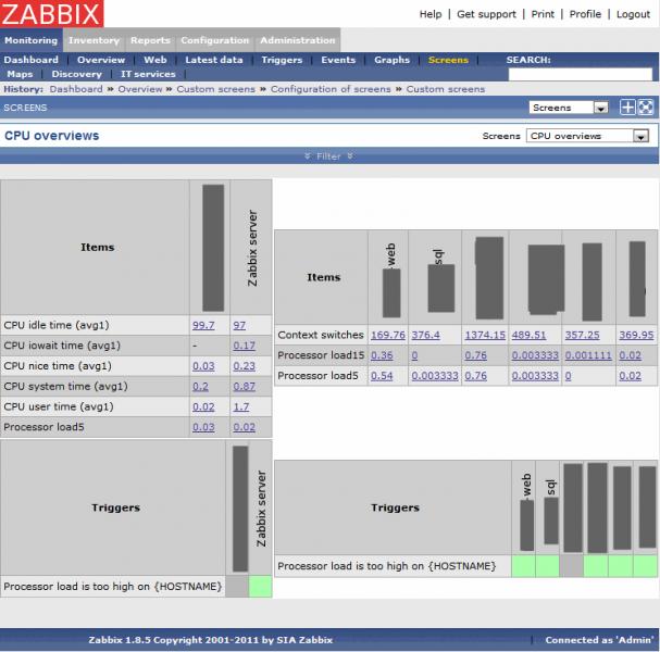

          It already works in the screens...
          when you create your screen, for data and trigger overviews, the patch is supposed to add an "Application" filter.
