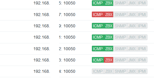

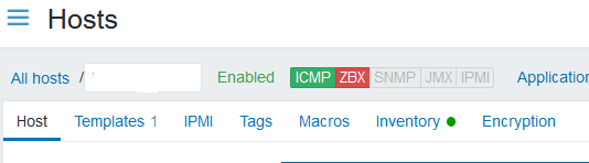

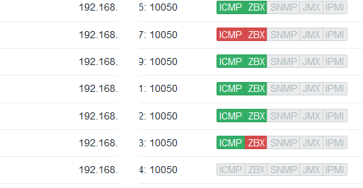

    A modification that adds a simple ICMP check status to frontend 5.2 with an icon next to the standard ones.
    Click image for larger version  Name:	icmp_aval_1.png Views:	0 Size:	20.8 KB ID:	413764
    Click image for larger version  Name:	icmp_aval_2.png Views:	0 Size:	8.8 KB ID:	413765
    It consists of 3 components:
    1) Modification of the zabbix database db_update.sql (adding fields to the hosts table. Does not affect the rest of the work and updates. checked for updates 4.0 > 4.2 > 4.4 > 5.0 > 5.2)
    2) Changing php files in the frontend directory. (presented in the form of diff files. inside there is a path to the file being modified)
    3) Script icmp_avaliable.php and the icmp_avaliable.sh wrapper to run through the scheduler. Retrieves the status of all active icmpping keys via the API and updates the corresponding state in the database.
    How to configure:
    1) create a zabbix user with api request execution rights. To register it in the file icmp_avaliable.php.
    2) make changes to the database according db_update.sql. you can use the entire sql file or you can make changes line by line with monitoring of what is happening (recommended)
    3) change the php files in the frontend directory (4 files). Make sure to create a backup first!
    4) Attention! Script icmp_avaliable.php written to connect to the Postgresql database! To work with other databases, make changes to the ACCESS_CONNECTION_STRING database connection string and call the appropriate functions instead of pg_ )
    5) configure script execution in the scheduler icmp_avaliable.php (or icmp_avaliable.sh) with the frequency you need. First, try running it manually to control how it works.

    Interesting work, but why? that area is used by "Interfaces", ICMP is NOT an interface, why would you put it there?
    I tnink tihngs work better the other way around, I know ICMP is working for a host unless I find it in problems list
    • Hamardaban
      • May 2019
      • 2714
      First, it is placed here, because I think the lack of an INTERFACE for simple checks is an architectural flaw of the developers. Secondly, most of the questions that zabbix users (who do not read the documentation) have : why does the host work and the ICON is gray? Now green! :-)
