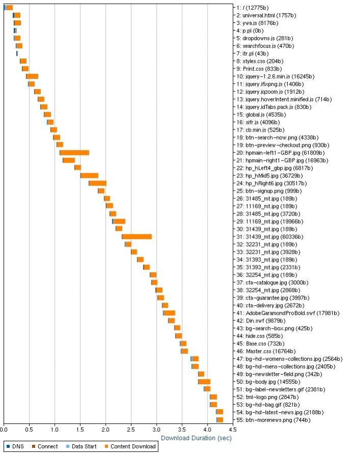

          There are a few things with using Zabbix for this anyway that I probably need to think about as Ideally I would like to produce more comprehensive graphing of test results than I believe is possible in 1.8 e.g. for each test I ideally want to be able to produce a graph similar to this:

            ooooh. now that's detailed. making this easy to get with zabbix would be exciting. i'll be following your progress

                Originally posted by anrstone
                Not really what I wanted to do - but might be OK. I'm not sure I want to have to run a proxy to perform this test but I'll give that some thought. I guess I would like a bit more flexibility to be able to run this as an agent which gives me more platform choice for the remote testing location.
                That all said I've not looked heavily at Proxies yet so I'll finish off the testing part to gather the data I need and then see what the best step is from there.
                [ATTACH]2497[/ATTACH]
                could you show us how you did to get this graph? thanks

                  So I've got to the point where I have the data (more or less) the bit I'm struggling with is how to get it all in to Zabbix in a sensible way. I can pass back detailed summary information which show's the same detail at the page level and I can also pass back an ascii style list showing the data but I kind of think (and I'd really appreciate people's views) that it would be useful if you could pass back a list as a single record and then use that as the basis for some kind of graph within Zabbix... It would mean having a new option(s) within the Zabbix UI to display a single result as graph / chart.
                  With regard to how I got the example picture - i'm afraid I screen grabbed something from another system we have here but I doubt it would be hard to create to be honest - the trick is having the data in the first place.
