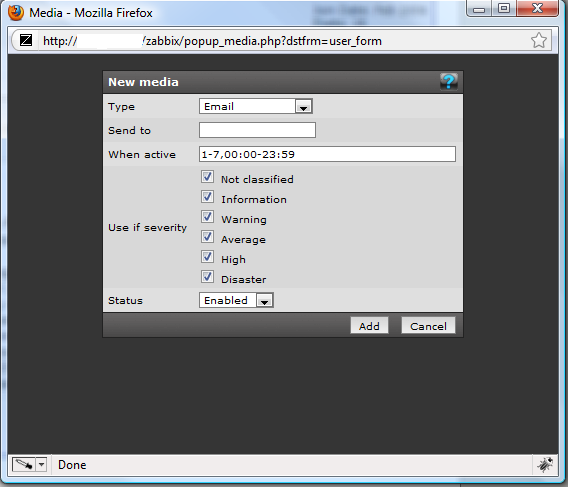

    Useful: Be able to schedule where the notifications are sent based on time periods. Keep it simple. For those with complex requirements, would be better served by an application outside of Zabbix to accomplish that task. I would guess that most of your installed base are guys like me who try not to work 24 X 7, can't be glued to their e-mail all day, and whose main job is not to watch a wall of monitors errors all day long.
    You can already do this too! In the User's media set-up you can define periods (days, hours) in which each media is to be used. For example, emails during working hours, sms after-hours.

      You can already do this too! In the User's media set-up you can define periods (days, hours) in which each media is to be used. For example, emails during working hours, sms after-hours.MrKen
      WOW! I was initially confused by what you wrote, but learned your response was exactly correct. I have multiple installations of Zabbix, but all but one are on 1.6. The one that I upgraded to 1.8 a few days ago does indeed have EXACTLY what I need. That's perfect! Thank you for pointing that out.

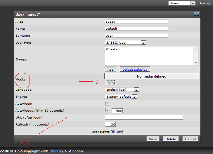

          This functionality is available in 1.6, and even in 1.4. And judging by the image in the 1.4 manual, it was available in 1.1 MrKen...In the User's media set-up you can define periods
          Hi MrKen,
          I'm going to have to say you are wrong on this one too. None of the 1.6 User setup windows even have the word Media on them. I don't know where you're seeing it, but I'm guessing you don't have a version 1.6 to look at.

            Looks like 1.6.5 to me!

              Oh no! I'm going to have to eat crow on this one. I looked all over that screen for the word Media before, and before I posted. They hid it in plain sight on me. The only thing different between 1.6 and 1.8 is where they put it. Crawling back under my rock.

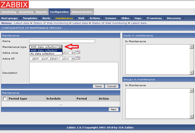

                I think this option solves that problem. I am just now trying this for the first time, but it would appear to do so. Note: Using v1.8.3 release.
                Edit: I would also like to point out that this entire maintenance feature is either not documented or is difficult to find in the manual.

                    I got a chance to test this today. One of our hosts that was scheduled to have updates installed was rebooted multiple times (it had a lot of windows updates to be installed).
                    I didn't receive a single alert for that host during this time.

                        We use maintenance mode and have over 1000 hosts (a lot setup with only snmp traps) and we don't receive a single alarm during maintenance. The key is to setup (as another poster mentioned) maintenance with no data collection AND add to the action Maintenace status = not in maintenance. We also don't get many if any false alarms. I spent about a week tweaking triggers and actions when we first switched to Zabbix. Taking the time upfront planning it out definitely helped our deployment.
                          There we go. That's a clearly spelled out key piece of information. I wouldn't go back to this after what I have now since I've come to rely on nested groups, cross-Zabbix-server groups, and global Zabbix servers notifications.
