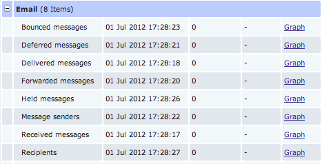

    First proof of concept: Postfix
    So, I've put together a first test setup and I'm liking the results so far. I took the sample from http://www.zabbix.com/wiki/howto/mon...itoringpostfix and tweaked it. I replaced the cron script with a python script that outputs key-value pairs:
    #!/usr/bin/env python
    from os import *
    statsscript = 'sudo /usr/sbin/pflogsumm -h 0 -u 0 --bounce_detail=0 --deferral_detail=0 --reject_detail=0 --no_no_msg_size --smtpd_warning_detail=0 /var/log/mail.log'
    fd = popen(statsscript, 'r')
    for ln in fd:
            if ln.strip() == 'messages':
                    break
    for ln in fd:
            if ln.strip() == 'Per-Hour Traffic Summary':
                    break
            if not ln.strip():
                    continue
            (val,key) = ln.strip().split(' ', 1)
            key=key.strip()
            val=val.strip()
            print "postfix[%s]:%s" % (key,val)
    postfix[received]:4
    postfix[delivered]:4
    postfix[forwarded]:0
    postfix[deferred]:0
    postfix[bounced]:0
    postfix[rejected (0%)]:0
    postfix[reject warnings]:0
    postfix[held]:0
    postfix[discarded (0%)]:0
    postfix[bytes received]:3596
    postfix[bytes delivered]:3596
    postfix[senders]:3
    postfix[sending hosts/domains]:2
    postfix[recipients]:2
    postfix[recipient hosts/domains]:2
    My zabbix_agentd.conf has
    UserParameter=postfix[*],zbxcache /etc/zabbix/scripts/postfix 290 'postfix[$1]'
    zbxcache is a C wrapper to memcached I threw together as a stepping stone towards implementing this functionality directly in zabbix_agent

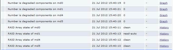

      Linux MD RAID devices, with discovery
      For the agent config
      UserParameter=md[*],/usr/local/bin/zbxcache /etc/zabbix/zbxmd.py 60 'md[$1,$2]'
      UserParameter=md.discovery,/usr/local/bin/zbxcache /etc/zabbix/zbxmd.py 60 md.discovery
      The python script to gather the stats and generate the discovery info. It needs python 2.5 for the JSON module, and a new enough Linux kernel that exports the MD stats in sysfs
      from glob import glob
      import os
      import json
      devices = []
      for devpath in glob('/sys/block/md*'):
              device = os.path.basename(devpath)
              devices += [{'{#MDDEV}':device}]
              for prop in os.listdir(os.path.join(devpath,'md')):
                      proppath = os.path.join(devpath,'md',prop)
                      if (not os.path.isfile(proppath)):
                              continue
                      if (not os.access(proppath, os.R_OK)):
                              # write-only file, ignore
                              continue
                      try:
                              f = open(proppath, 'r')
                              val = f.read()
                      except:
                              continue
                      print 'md[%s,%s]: %s' % (device,prop,val),
      print 'md.discovery:', json.dumps({'data':devices})
      I haven't tested the prototype triggers yet
