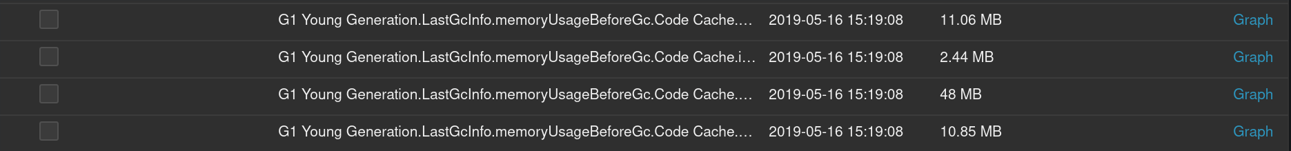

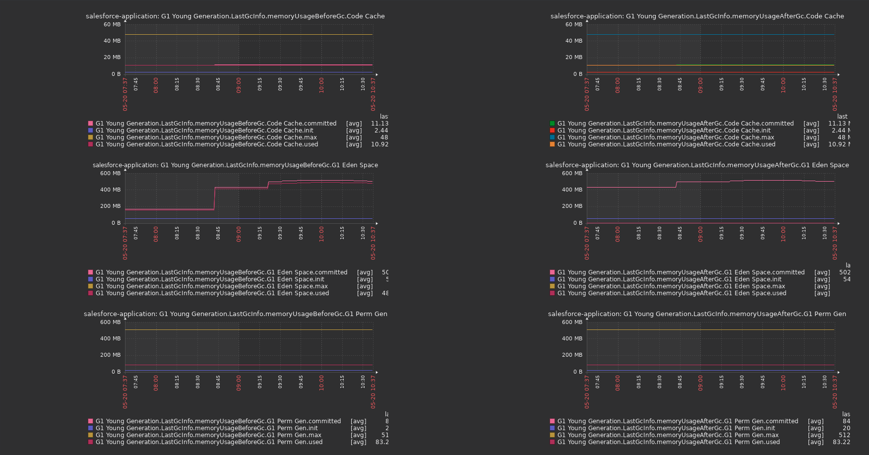

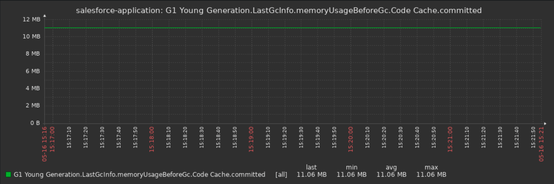

    Unfortunately, Zabbix didn't support tabular datatypes. After a bit of research, I stumbled across this post from 2015 where some guy had submitted a patch to support, enabling tabular datatypes https://support.zabbix.com/browse/ZBXNEXT-2727. This didn't work for every scenario including grabbing the attributes above. I've taken this patch and tweaked it to work for the Composite structure above. It' would be nice to see this included at some point I'm not a developer so it may need cleaning up but I can confirm this works on v4.2.
    You can get the attribute the same way as you normally would using dot notation. For eg: jmx["java.lang:type=GarbageCollector,name=G1 Young Generation","LastGcInfo.memoryUsageBeforeGc.Code Cache.max"]
    Click image for larger version  Name:	Screenshot from 2019-05-20 10-37-47.png Views:	1 Size:	116.1 KB ID:	379172
    Click image for larger version  Name:	Screenshot from 2019-05-16 15-19-48.png Views:	1 Size:	68.4 KB ID:	379060
    Click image for larger version  Name:	Screenshot from 2019-05-16 15-22-06.png Views:	1 Size:	142.0 KB ID:	379061
    Click image for larger version  Name:	Screenshot from 2019-05-16 15-22-44.png Views:	1 Size:	145.7 KB ID:	379062
