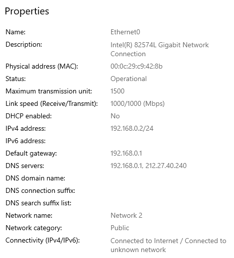

        2- Windows network
        The template "Template OS Windows by zabbix agent" include "Template Module Windows network by Zabbix agent"
        but i dont have any network informations.

        Here is my network configuration:
        Is there something i am missing to get it work ?

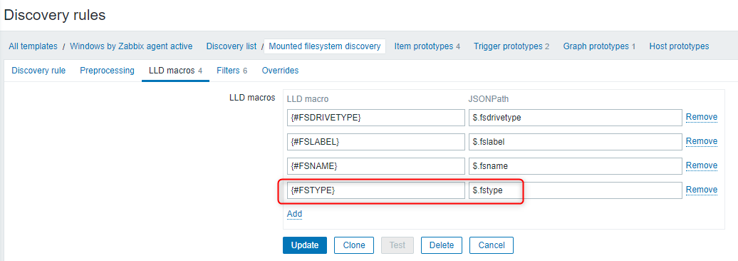

                              #45
                              The most recent (6.4.0) Template misses a LLD macro, because of this no Labels are shown within the Filesystems Items or Triggers.
