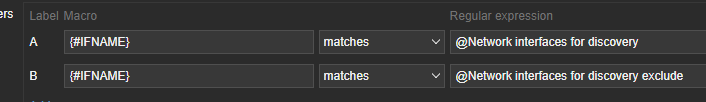

                          • epizarro
                            • Sep 2020
                            Interface Speed doesn't work for any vfio virtual interface, this because vfio nics doesn't have speed limit. Like any proxmox vm. Set a preproc with range limit and set value 0 to fail
                            Click image for larger version  Name:	image.png Views:	3 Size:	4.5 KB ID:	467281h
                            also, network discovery should ​pint to system regular expression:
