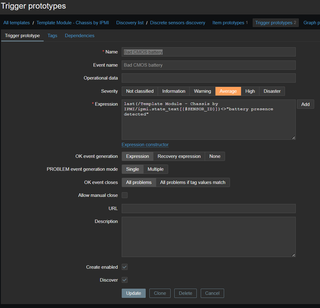

        I notice that the template creates triggers using non-existing values/discovery macros, e.g.:
        IPMI: Ambient value is above non-recoverable high (greater than {#SENSOR_HI_DISAST} for 5m)
        with expression:
        ipmi.value[Ambient].min(5m)}>{#SENSOR_HI_DISAST}
        This causes the trigger to be deactivated (unsupported).
        I assume that the Discovery process should have populated these thresholds?
        Please advice on how I can troubleshoot this missing/faulty discovery.

                  ​Hey.
                  I'm trying to create a trigger only for the "CMOS battery".
                  So I went the trigger prototypes way and added a new one for CMOS battery check.
                  It works at all, but it's been applied on all sensors.
                  Here's a screenshot of the trigger.
Name:	CMOS battery trigger prototype.png
                  I tried to replace "{#SENSOR_ID}" by "CMOS Battery" but as expected, it can't be setup like this.
                  I also tried to create a static trigger with the expression
                  last(/Template Module - Chassis by IPMI/ipmi.state_text['CMOS Battery'])<>"battery presence detected"
                  But, as expected, I end up with the following error
                  Incorrect item key "ipmi.state_text['CMOS Battery']" provided for trigger expression on "Template Module - Chassis by IPMI".
                  Is there a way to match "{#SENSOR_ID}" in a trigger prototype (or any other variable) to avoid this trigger being applied to all discrete sensors checks ?
                  I'm starting to run out of ideas, so if anybody has any advice/idea on this subject, it would be appreciated.
                  Thanks a lot.​​​​
