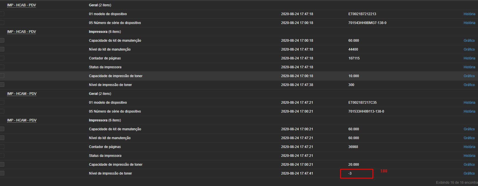

    Nivel de toner diferente com a coleta do zabbix a impressora lexmark está com 10 % e o zabbix mostra que está -3
    o que pode ser?
    chave = prtMarkerSuppliesLevel
    SNMP OID = .1.3.6.1.2.1.43.11.1.1.9.1.1

    Dica 02: as documentações dos oid's ficam na MIB, e numa pesquisa rápida por "prtMarkerSuppliesLevel" você acha a descrição dessa chave (eu olhei no https://oidref.com/1.3.6.1.2.1.43.11.1.1.9) e os valores dela vão de -1 à -3:
    prtMarkerSuppliesLevel OBJECT-TYPE
    SYNTAX Integer32
    MAX-ACCESS read-write
    STATUS current
    DESCRIPTION
    "The current level if this supply is a container; the
    remaining space if this supply is a receptacle. If this
    supply container/receptacle can reliably sense this
    value, the value is sensed by the printer and is
    read-only; otherwise, the value may be written (by a
    Remote Contol Panel or a Management Application). The
    value (-1) means other and specifically indicates that
    the sub-unit places no restrictions on this parameter.
    The value (-2) means unknown. A value of (-3) means that the
    printer knows that there is some supply/remaining space,
    respectively."
