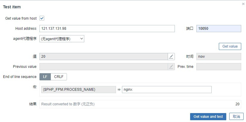

    I test proc.num["{$PHP_FPM.PROCESS_NAME}"]
    if proc.num("php-fpm") = 0,this is error,the ok num = 2
    proc.num("nginx") = 2 ,is ok
    I think proc.num is not support '-'??
    • FLFQ
      • Mar 2021
      • 9

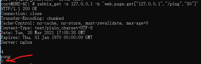

                nginx run as www-data
                php-fpm run as www-data
                nginx return is right
                php-fpm return is error

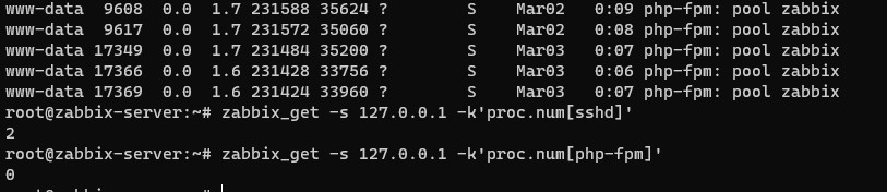

                  test cmd:
                  zabbix_get -s 127.0.0.1 -k'proc.num[php-fpm]'
                  • FLFQ
                    • Mar 2021
                    • 9
                    test cmd:

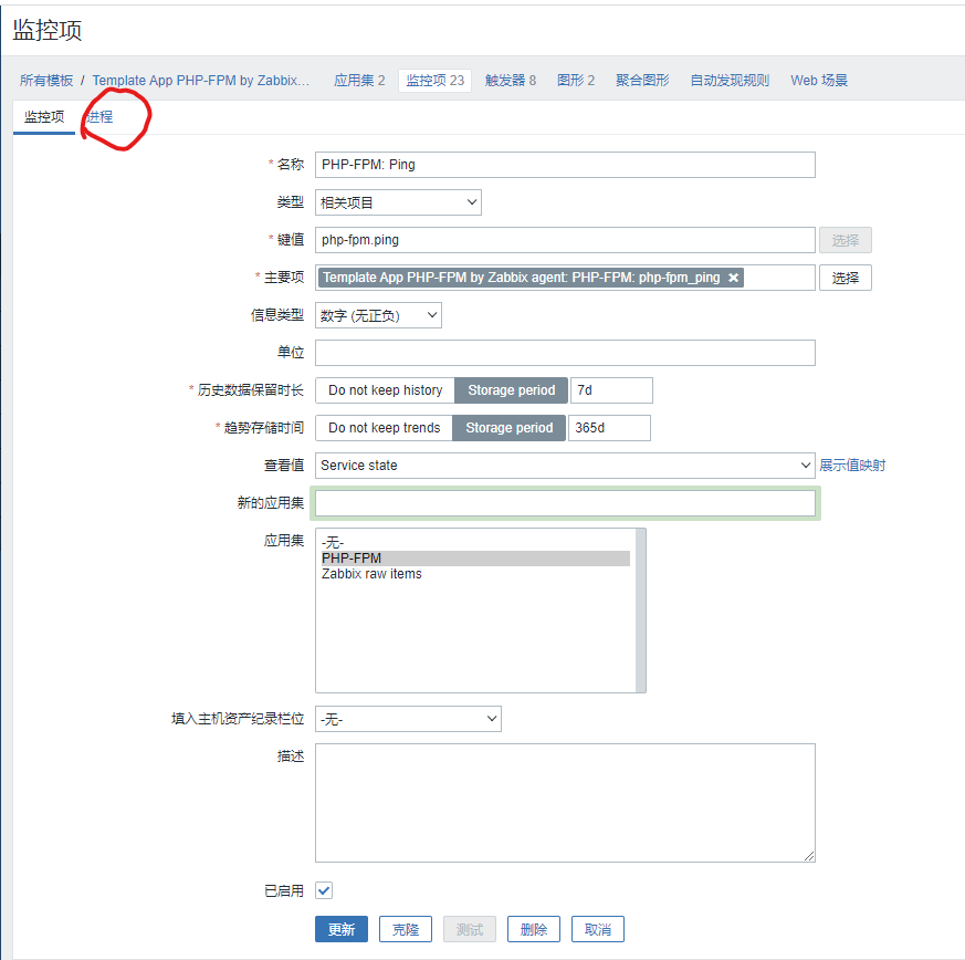

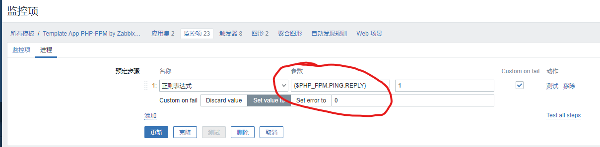

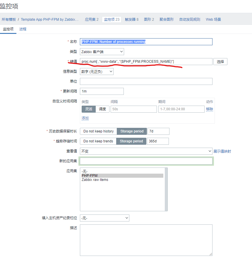

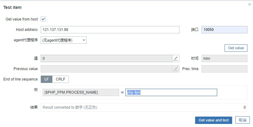

                        fix it:
                        Click image for larger version  Name:	1.png Views:	0 Size:	50.8 KB ID:	421793
                        Click image for larger version  Name:	2.png Views:	0 Size:	48.7 KB ID:	421794
                        Click image for larger version  Name:	3.png Views:	0 Size:	32.9 KB ID:	421795
Name:	屏幕截图 2021-03-31 012618.png
                        • dgibbs
                          • Aug 2022
                          Since it took me way to long to resolve this myself. Here is the simple fix for the PHP-FPM by Zabbix agent template
                          1. Add a new macro to the template
                          the user is typically www-data but do ps -ef|grep php-fpm to confirm
                          Macro: {$PHP_FPM.USER}
                          Value: www-data
                          2. Update existing Item "PHP-FPM: Number of processes running" key
                          from
                          to:
                          proc.num[,"{$PHP_FPM.USER}",,"{$PHP_FPM.PROCESS_NAME}"]
