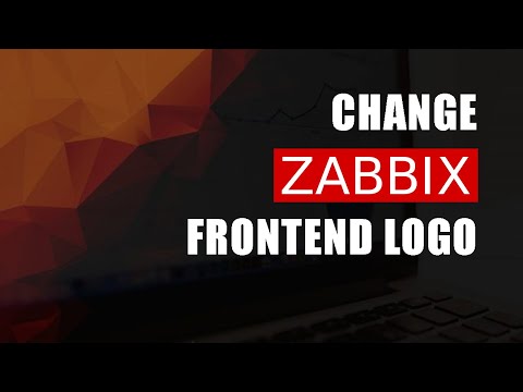

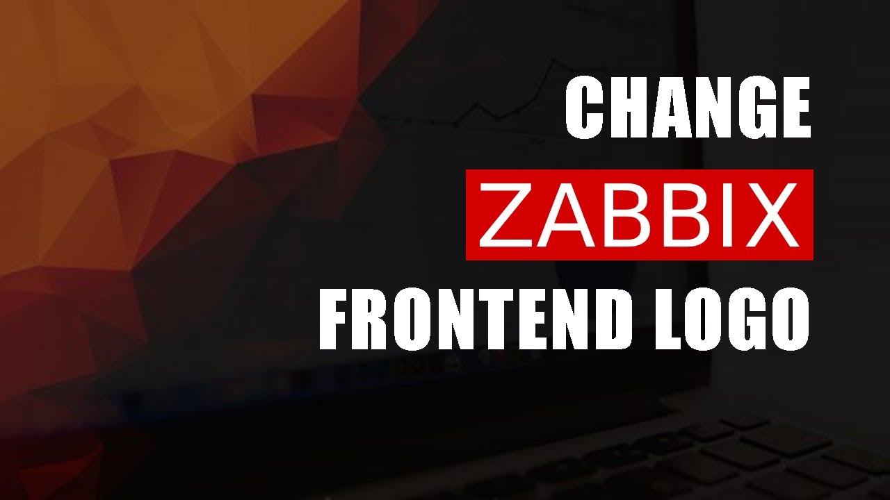

      Hi, I recorded this video 2 years ago, and can't guarantee that it will work on recent releases, but give it a try.
