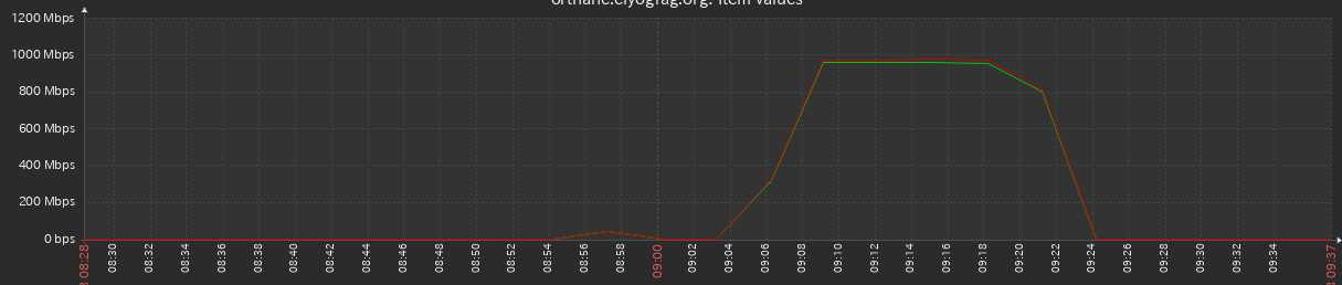

    This is the text of the alert that I got this morning from zabbix monitoring my dd-wrt router with SNMP:
    Problem started at 09:24:17 on 2022.08.28
    Problem name: Interface vlan1(): High bandwidth usage (>90% )
    Host: orthanc.elyograg.org
    Severity: Warning
    Operational data: In: 160.71 Kbps, out: 499.1 Kbps, speed: 1 Gbps
    Original problem ID: 1008095
    Looking at the bandwidth graph I can see why it triggered -- because the trigger looks at averages. The problem I see here is that the alert shows the values at that time, not the average values that triggered the alert. Can I get the average in the alert? If so, can it be changed in the SNMP template that came with zabbix? Here is a list of zabbix packages installed on Ubuntu 22:

    Another interesting thing: Looking at the dd-wrt config, vlan1 is assigned to switchports that have nothing plugged in. So I need to have a discussion with dd-wrt support about why SNMP shows nearly 1000 Mbps on a vlan that should never see any traffic at all.
  • elyograg
    • Aug 2021
    • 37
    There is a bug in the DD-WRT web UI. All the switchports are actually assigned to vlan1 even though the UI says otherwise. And I know what caused the traffic, the alert from zabbix was completely legit.
    All that's left is figuring out whether the alert can show the average numbers instead of the traffic at the time of the alert.
