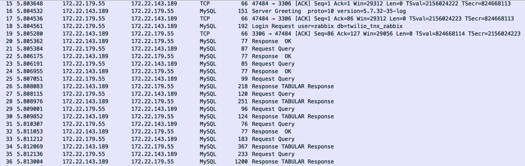

    Looking around I found that the current MySQL communication with the server is not being encrypted:

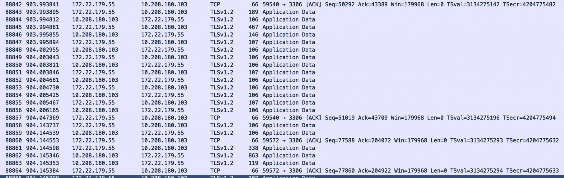

    However, towards RDS TLS is being used:
