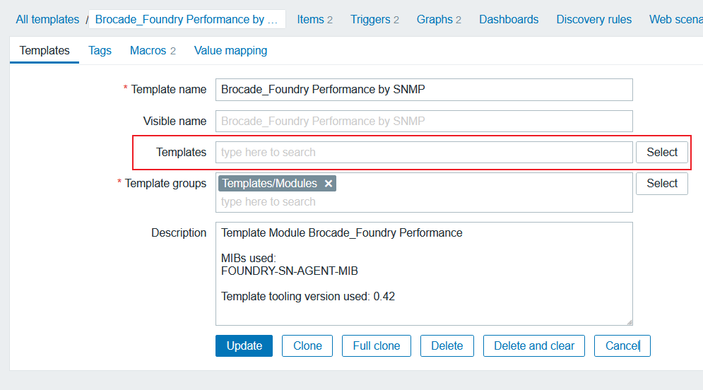

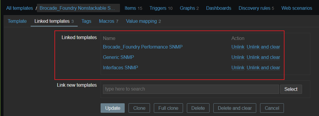

    I have been using Zabbix since v4.x, and I noticed that in v6.x the readily available templates have "Linked Templates" changed into "Templates", this is not a problem, but for those templates hiding the actual dependency on other templates by simply creating those items on the template level is not a good idea. For example, in previous zabbix versions, it was clear that switch interfaces are discovered by using the template "interfaces SNMP":
    Click image for larger version  Name:	image.png Views:	0 Size:	32.4 KB ID:	459585​
    Now in v6.2, this looks like this, linked templates is empty:
    So that the user is agnostic concerning the actual origins of the items... This was a bad idea, indeed!! I don't really understand why this has been made this way..

    What version do you have installed? There was such error - but it was fixed a long time ago.
    But further - more: in version 6.4, they plan to remove template nesting altogether. https://www.zabbix.com/documentation...esting-removed

      I have both Zabbix 5.4.12 and 6.2.7, I am planning to migrate to 6.2.7, this thing appears in 6.2.7, then it appears to be by design, since I am looking at the template in 6.2.7 and it seems that all items are merged under the template, ignoring actual templates from which items have been inherited, that's is complete crap indeed, bad decision.
