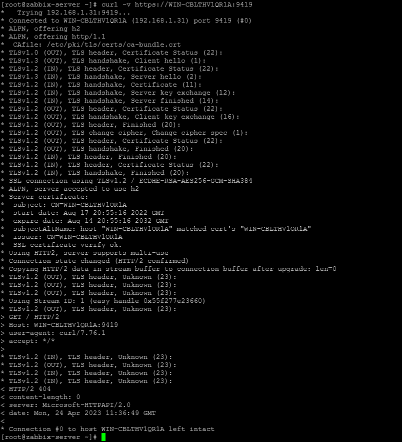

    Hi, I have zabbix 6.4 and Veeam Bakcup & Replication v11.0.1.1261
    I wanna use Veeam Backup and Replication by HTTP template for backup job status. I configured basic settings in templete connection settings area. As like attached http url, user name and password field i was configure but i get this {"error":"Error: cannot get URL: Couldn't connect to server."}
    i was created veeam user named "api_user" and give it viewer role, but i also tried give to it "Backup admin" role i see same issue​.
    I tried install wireshark on destination veeam server.
    I never see that any traffic from zabbix server to veeam server. I tried manuel request with curl and i see traffic. Any no access restriction.​
    As if traffic never go from zabbix server with user template.

            same issue here, user with Backup Viewer permissions created, curl -k shows proper connection to the API port.
