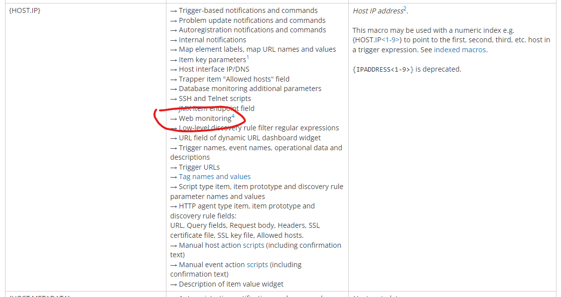

      In a different part of the same documentation you will notice this difference, which seems deliberate:
      HOST.IP specifically says its supported in Web Monitoring
      Click image for larger version  Name:	zabbix host ip.png Views:	0 Size:	100.6 KB ID:	477694

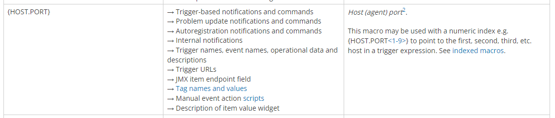

      However HOST.PORT doesn't list Web Monitoring as supported
      Click image for larger version  Name:	zabbix host port.png Views:	0 Size:	42.8 KB ID:	477695

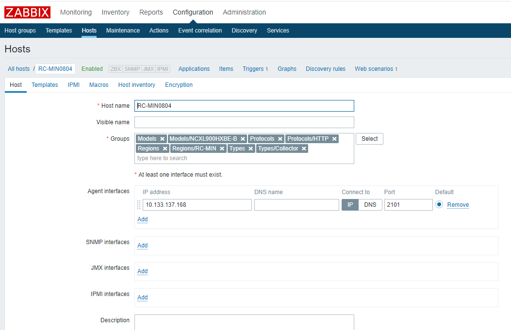

            Here's how we have our hosts configured (agent IP address + non-standard Port)

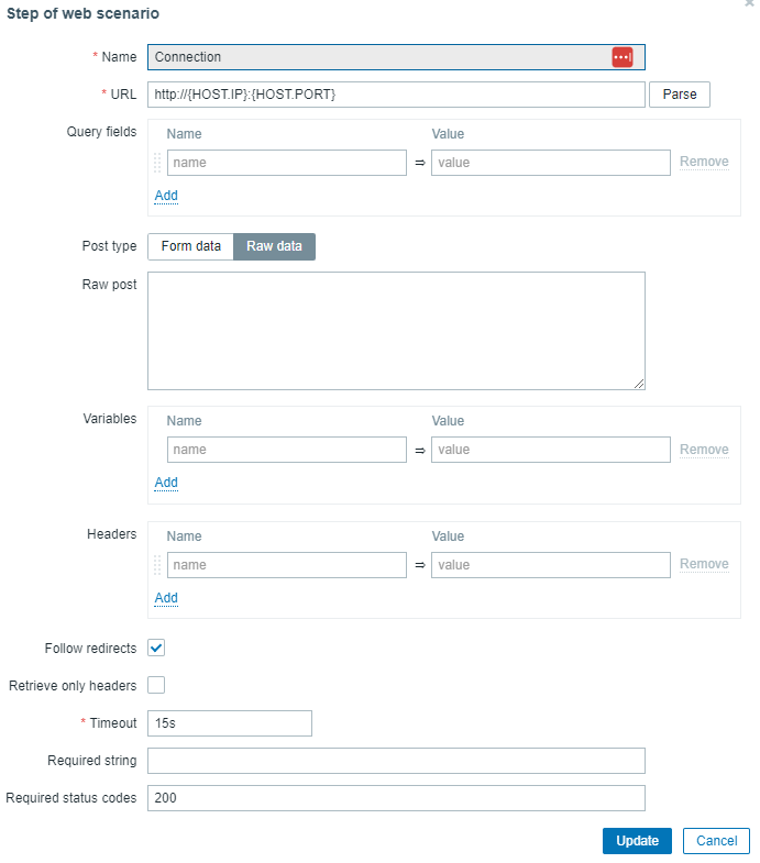

            This is how the web scenario is configured:

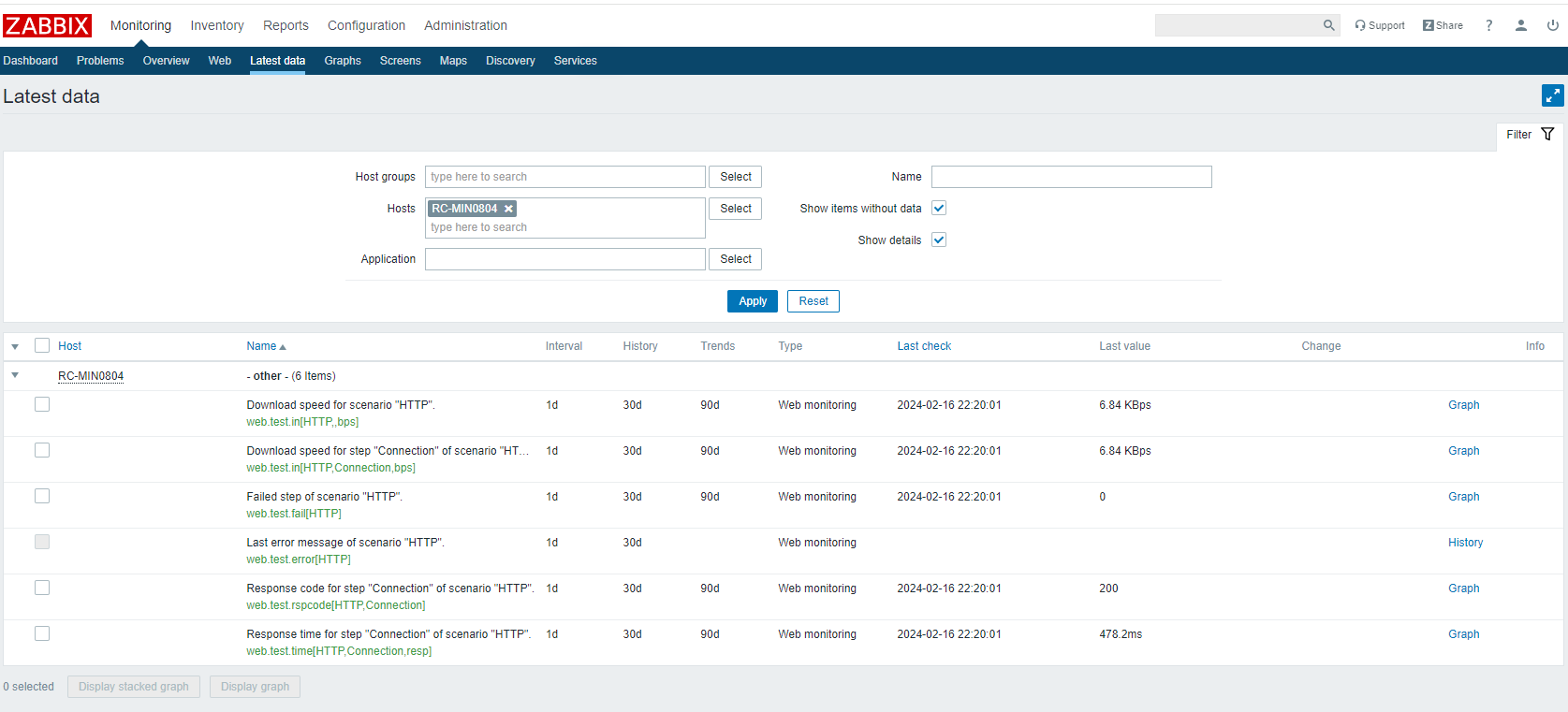

            What we see in Latest Data (seems to be working fine and collecting data):
