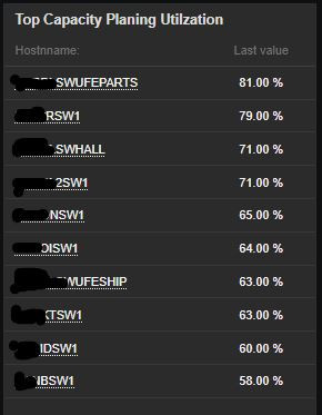

    Cool thing to represent the datas: Top host widget
    :Click image for larger version  Name:	Capture.jpg Views:	0 Size:	25.9 KB ID:	480080

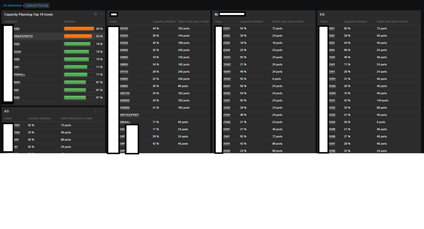

    Here is how I made my dashboard:
