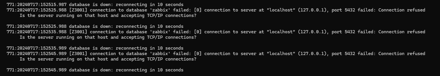

        See the logs
        • Jason
          • Nov 2007
          • 431
          That is saying your database isn't running. Take a look at postgres and see what is going on there.

              The error message talks about port 5432, which is used for PostgreSQL. Please ensure that you are using the correct zabbix-server-mysql package, and not the zabbix-server-pgsql one, if you are using MySQL database.

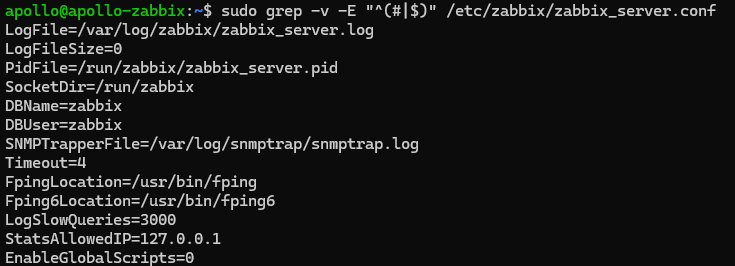

                  sudo grep -v -E "^(#|$)" /etc/zabbix/zabbix_server.conf
                  Markku
                  • Lewis Wiltshire
                    • May 2024
                    • 33
                    Markku
                    see attached

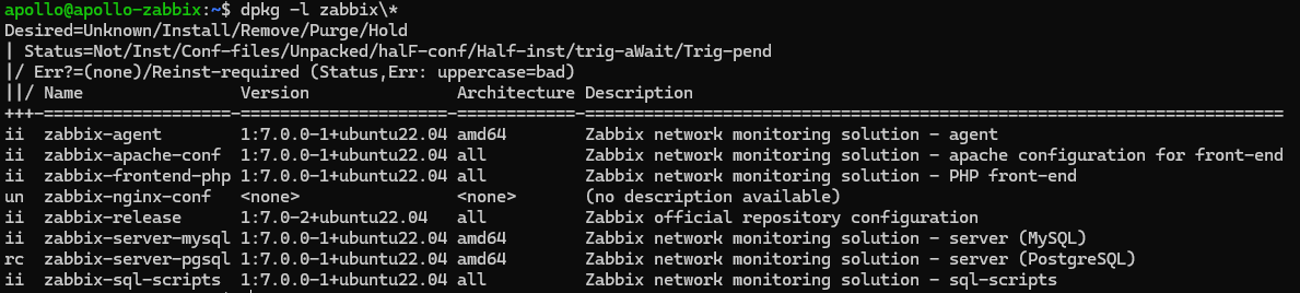

                      dpkg -l zabbix\*
                      Markku
                      • Lewis Wiltshire
                        • May 2024
                        • 33
                        dpkg -l zabbix\*
                        Markku
                        see attached

                          What's your personal idea, why would your Zabbix server (zabbix-server-mysql) try to connect to PostgreSQL server port 5432, as you told us it was still doing after the server reboot?
