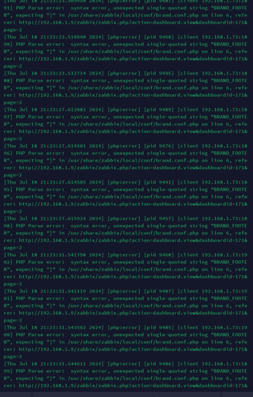

                I get the attached

                  Originally posted by Donkey
                  Well there you go, you've got an error on line 6 of /usr/share/zabbix/local/conf/brand.conf.php
                  Share the contents of that file on here if you want.
                  Thanks sorted it. Had a space in the file name
