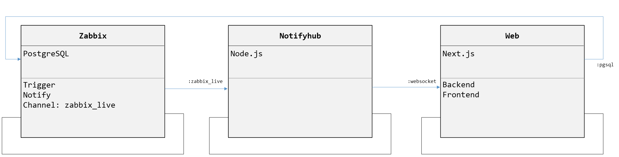

    I have implemented a complementary system to view live data as soon as inserted in Postgresql. It uses postgresql notifications and websockets instead of pull model in the frontend.
    Components: Zabbix Postgresql DB + Websocket server + Next.js Web Application
    Project link: https://github.com/ersinesen/zabbix-live
    I found it hard (and unnecessary) to insert these components into zabbix project itself. Any suggestions on such a feature in zabbix?
    Thanks.

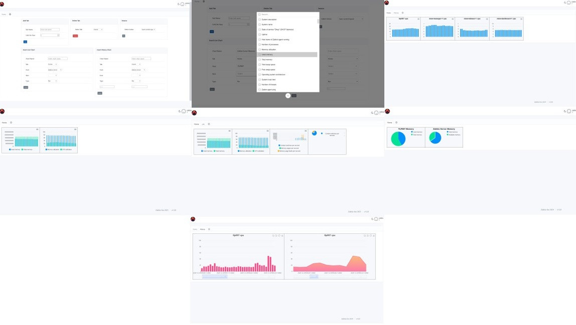

    Sample screenshots
      • 5002
      With this I can just say.. OK, you created it...
      But you must have had somekind of usecase for this? Maybe its just a time of the day and lack of coffee or something, but I just need somekind of explanation, why it was created ..
      • ersinesen
        • Dec 2024
        It is just a different mode of display using websockets that enables visualising inserted data immediately. I want to push the websocket server to its limits and be able to see data of thousands of agents on a single dashboard in realtime.
