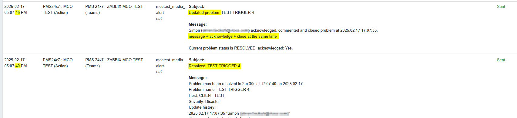

    I noticed that when I post an update message and manually resolve a problem in one step, the update message is published after the recovery event. This makes the event log a bit confusing because the update message appears after the recovery, while logically, it should be the other way around.
    Would it be possible to change the order so that the update message is published before the recovery event? Or perhaps provide an option to control this behavior?

  • simon25111
    • Feb 2025
    Here the action log details : as you can see the update is sent after the recoveryClick image for larger version

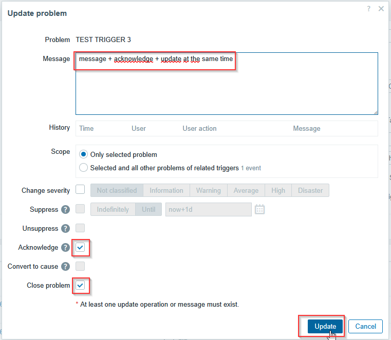

              ### Issue with Event Order When Handling Problems
              Our standard process for handling issues follows these steps:
              1. **Problem detected**
              2. **Update problem:** Check the **"Acknowledge"** checkbox
              3. **Create Jira ticket**
              4. **Update problem:** Send message + check the **"Close problem"** checkbox
              With this workflow, the **update** and **close** actions are executed in the correct order:
              first, the acknowledgment message is sent, followed by the close message.
              ### Issue with Early Jira Ticket Creation
              However, some users create the Jira ticket **before** acknowledging the issue. Then, they acknowledge and close the issue in the same update. This modifies the process as follows:
              2. **Create Jira ticket**
              3. **Update problem:** Send message with the ticket number + check **"Acknowledge"** + check **"Close problem"**
              As a result, the **update event is sent after the closing event**, which is not the intended behavior.
              Additionally, the Zabbix update form allows both checkboxes (**"Acknowledge"** and **"Close problem"**) to be checked in a single update, further contributing to the issue.
