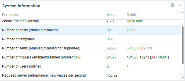

    I'm coming from Spectrum and I'm now migrating everything over to Zabbix. We’re talking about roughly 300 switches, around 50 servers, and various other devices — probably around 500 hosts in total.
    I started with everything installed on a single server, using PostgreSQL with TimescaleDB. All network devices use SNMPv3.
    I’ve just started adding the first devices and already had to scale up to 16 vCPUs. I have a lot of items because the switches are using templates, and with all the ports, they generate a large number of items and triggers — though the numbers are still small compared to what I’ve read in other setups.

    Do you have any suggestions?
    Would moving the DB to a separate server help? I don’t really need proxies from a technical standpoint, but I’m wondering if they could help with performance anyway. I definitely plan to optimize the default templates to avoid generating unnecessary items.

      Jimmy82 Split that installation up, add a proxy. Let server do the calculations, and proxy do the polling (one proxy with sqlite3 is OK for almost 1k nvps). Separate DB and frontend. I am pretty sure you can get away with 4 hosts with less than 16CPU in total. DB being the biggest of them probably...

        Hi everybody, thanks for the feedbacks. SO basically you both suggest to use the proxy (even it I'm really in the scenario, like two different location) to split some work loads.james589henry which guide are you referring to? It would be interesting to read it to know also the sizing of the servers. If I would go for a solution for example for 3 Servers, Fronted, DB (PostgreSQL+Timescale) and one Proxy, size of HD, CPE and RAM suggested. cyber in a full composition I will have for sure more that 1k nvps, probably 2 or 3k. Which proxy should, tho one with PostgreSQL as well?

          Sizing examples... installation with ~9k, nvps 13k hosts, 1.6M items, 855k triggers.. server host(s) 4 cpu-s 16G ram.. same size for proxies, but as we have corosync/pacemaker proxy cluster, it can handle running 2 proxies in one host... frontends 8cpu-s ad 8G .. DB (PG+TS) takes a bit more - 16cpu-s 128G RAM. Runs with load 4-6...load has gone down, maybe some code optimizations, maybe something else.... but I have seen it using all those cpu-s also.. DB is only one requiring disk space (depends how long you store data etc.. you can increase on the fly, if needed) .. others are pretty minimal.
          This setup survived also 13.5k nvps.. when some guys removed some filters and we got +50% of everything over the night..
          Proxy with sqlite3 manages with up to 1k nvps, easier to manage also, than to have separate DB-s for proxies etc.. if nvps gets higher, you can just add some more to spread the load..
