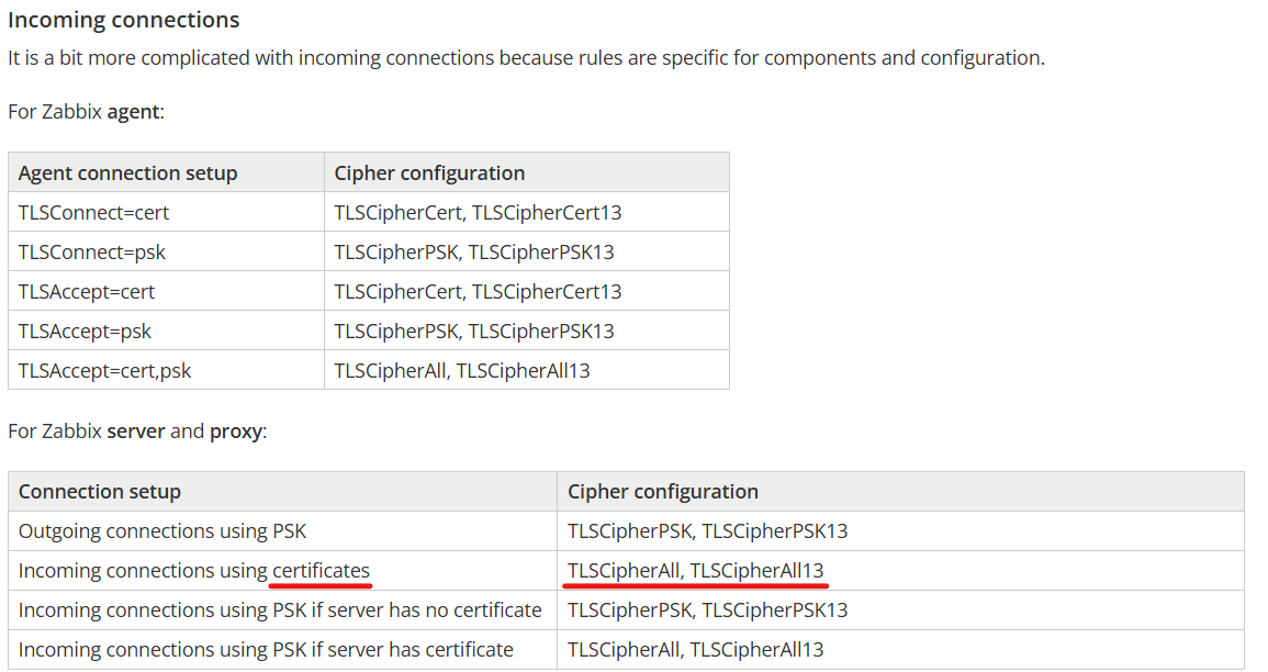

    Hello!
    When scrolling through the 17. Encryption -> User-configured ciphersuites -> Incoming connections chapter in the Zabbix documentation 7.4 (current), I found this area (marked in red) to be unusual. Shouldn't these Cipher parameters in Cipher configuration be TLSCipherCert and TLSCipherCert13? This row is talking about connections using certificates or am I not understanding what this means.

    You might be right.. there is this thing in footer
    Have an improvement suggestion for this page? Select the text that could be improved and press Ctrl+Enter to send it to the editors.
    But I think specifying "ALL" and using certs still works... Until there are cert-based ciphersuites used...
