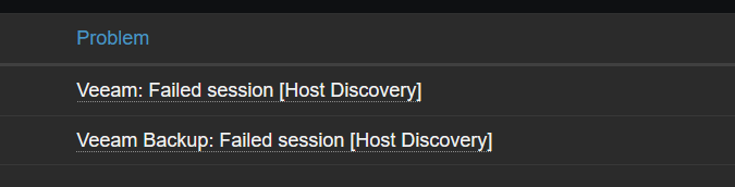

      after changing what you specified , i am getting this error
      • plastun66
        • Feb 2026
        So, your Host is monitoring in Zabbix, right?
        And you get alarms from Veeam B&R via HTTP API that say that Host Discovery sessions in Veeam ended with Failed status

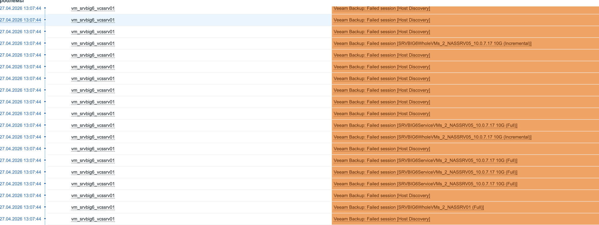

            • logrosdesign
              • Apr 2026
Name:	Снимок экрана 2026-04-29 в 12.19.34.png
ID:	513104Hi, do the same, change "x-api-version" in the get-data script (in two places) to version 1.3-rev1 all it's ok, but have this warning.
              Please help with solution
              • Hafamori
                • May 2025
                • 10
                I have the same issues. Lots of warnings after chaning the api string and upgrading to 13. Is there a fix available yet?
