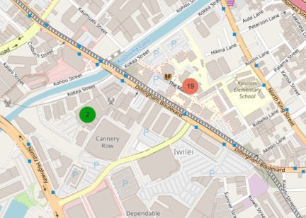

    I take it you want something like this:
    The GPS information is coming from the Inventory section of a host. So if your hosts is static as opposed to moving around this will work.
    As far as agents is concerned the hosts in the above map were using SNMP.

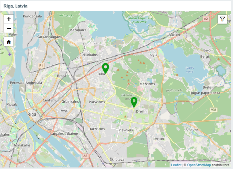

    Below is another example of using no agents at all.
    • created a host group called zzzz-demo1
      • created a host called zz-zabbix office with GPS of 56.96387,24.22067
      • created a host called zz-microtik office with GPS of 56.975,24.1883
    • made this dashboard with a GPS location of 56.965,24.2 and a zoom of 12
    And I am just using dashboards and widgets within Zabbix 7.0 LTS (currently at 7.0.25).

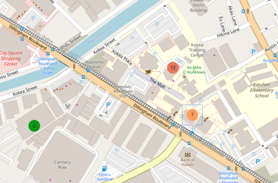

      To answer points #3 and #4 in the original note:
      If one zooms out on the Geomap I showed it will combine the number (12 and 7 for the 19) below. Likewise if I were to zoom in to the map it will show the 7 as 3 and 4 (3 in one room and 4 in another room sort of opposite sides of the building).

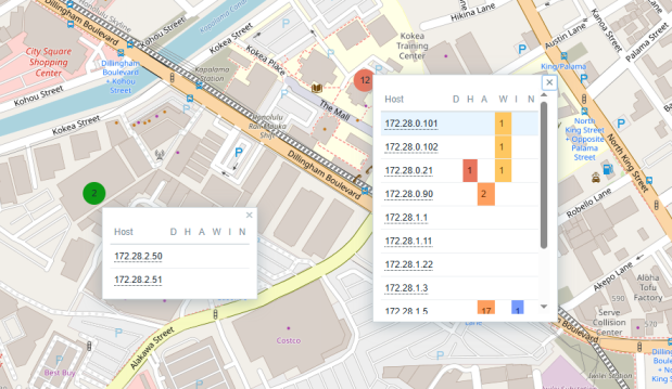

          An additional screen shot with the pop-up windows appear after clicking on the pins, the color of the pin would show the highest severity in the group (D=Disaster, H-High, A-Average, W-Warning, I-Information, N-Not classified).

            Okay, perhaps I should have said "that is what I want visually". But as I said at the start, I don't want alarms from these devices to flood the Problems view, which they would do; there are low hundreds of "not green"-devices at any given time, for multiple reasons. In Zabbix the pin/cluster colour is based on severity of alarm. I would need it to be based on given item/tag value.
