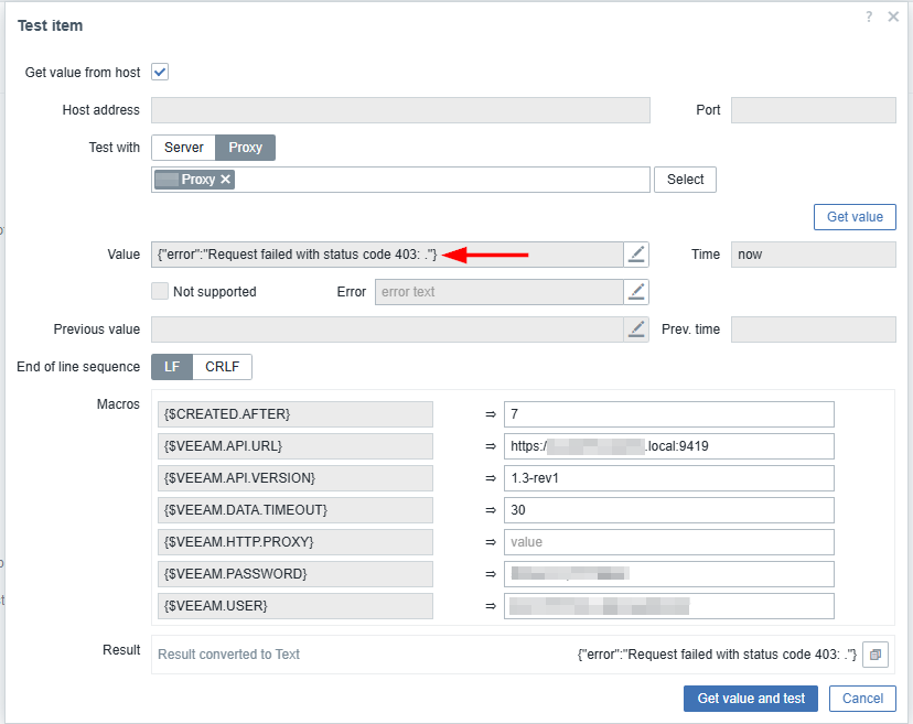

    Hope this will save some time to those struggling to make the Veeam B&R template work with Veeam B&R 13.
    I've just installed the Veeam template from https://git.zabbix.com/projects/ZBX/...ads%2Frelease% 2F6.0. It looks like it hasn't been updated since 22/01/2024, well over 2.5 years.
    I am on VBR 13.1.0.411, Zabbix Server 7.4.0 and a bunch of Zabbix Proxies ranging from 7.4.0 to 7.4.13 running on Ubuntu 24.04.LTS.
    The instructions state:
    Setup
    1. Create a user to monitor the service or use an existing read-only account.
    I found that a read-only account will be denied access and results in the following error:
    What fixed it for me is giving the user Backup Administrator in Veeam's Users and Roles dialog.
    If the permissions necessary to query certain metrics are higher than Backup Viewer / read-only access then the documentation is incorrect and should be updated to reflect it. Otherwise the bug should be fixed. Veeam 13 has been out for quite some time.
