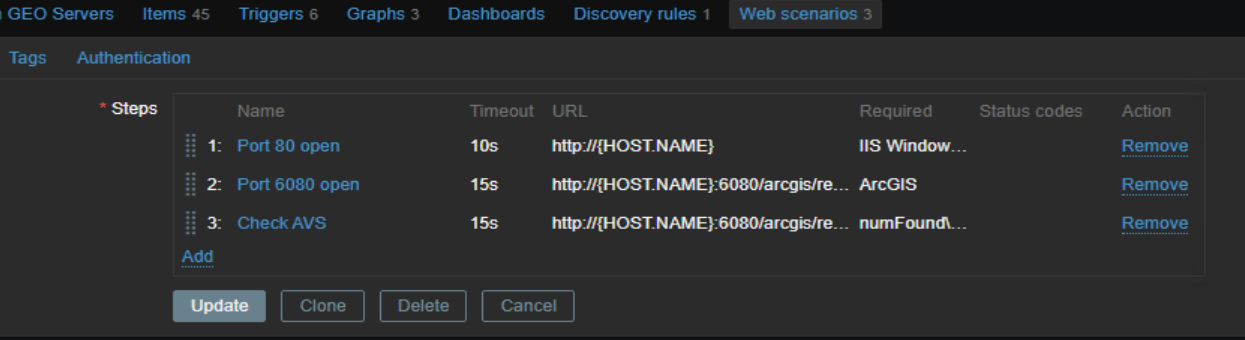

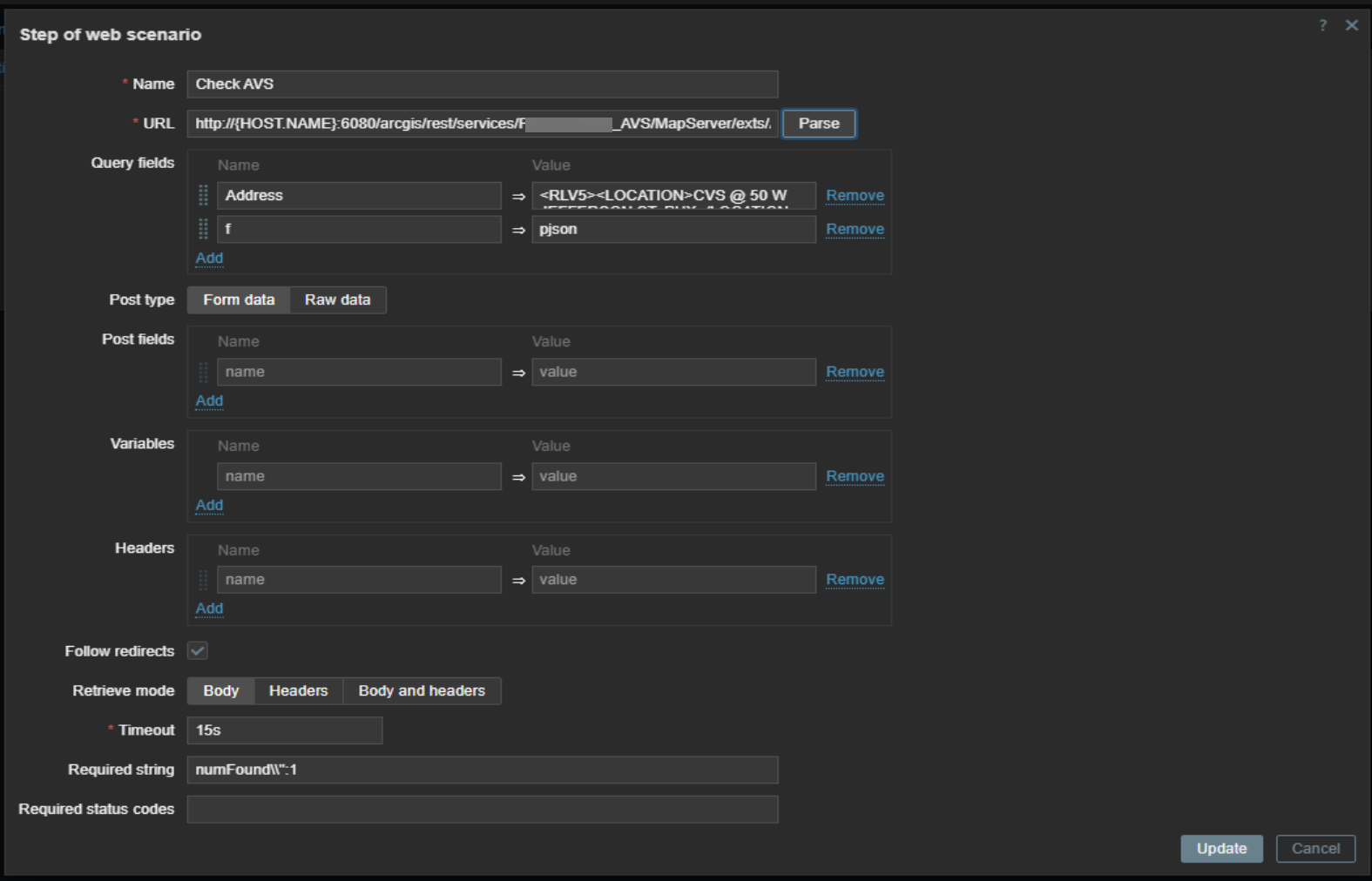

        I'm not sure if this is something you have looked into, but there are web scenarios, where you can setup custom checks of a webserver or application rest API.
        You have some flexibiitly on how to test your site:
