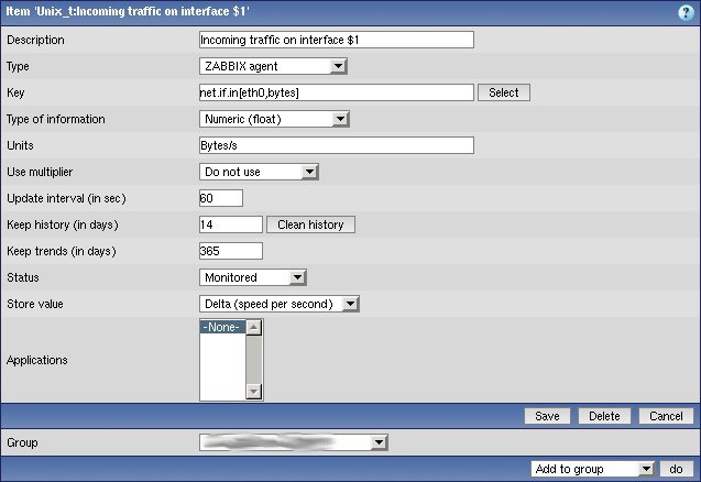

The problem exist if i get net.if. informations from Servers with GiBit NICs, RedHat Enterprise 4 Update 4 and high traffic. The delta p.s. is out of a logical range of Bytes per second
I've check the configuration. Is in .in and .out the same and looks right for me.

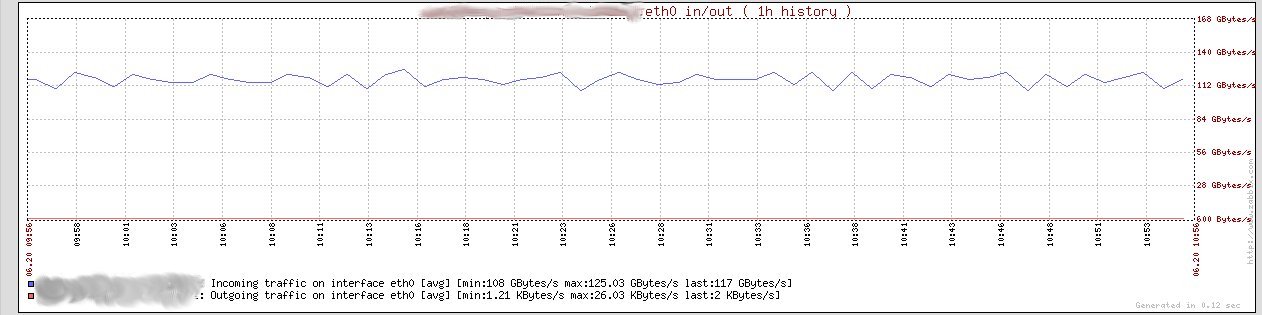

But this is the graph i get. I think i need a TerraBit NIC to get this kind of values.
I checks the validity of data by sending and fetching of a big file via ssh. On the big value i cant see any change
On small one shows me a logical value like the speed-counter by scp.
Firsttime i use an 1.1.2 agent on RedHat but updated it to 1.1.7 yesterday without an change.
Anyone know this problem? and have any idea to fix (without update to 1.4.x this is an project later in this year)?
i've a big problem on our zabbix-servers.
We use a zabbix-server 1.1.4 on a Debian stable server about political reasons.
