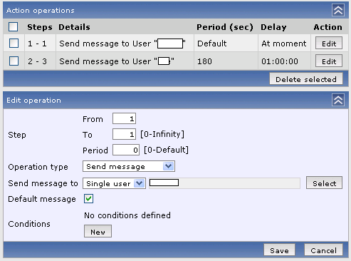

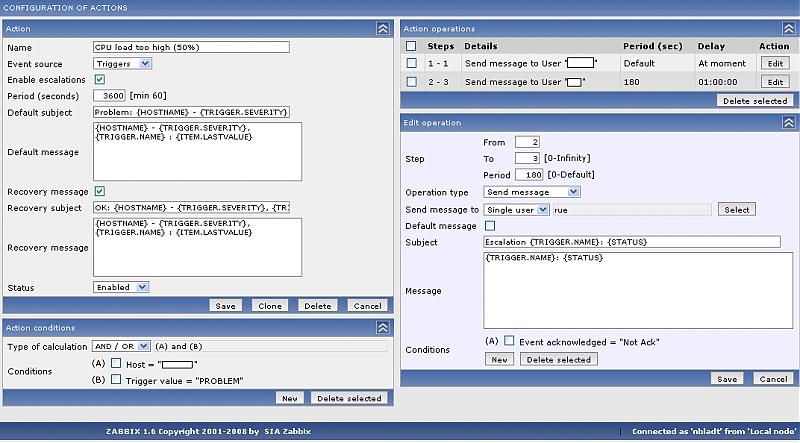

        Hi
        after reading your post I hesitated to check it. But, finally,
        the curiosity was bigger than the fear of an E-Mail flood.
        Especially if I configured to send E-Mail to a colleague
        If you configure it like me (see attachments) it works perfectly.
        We would like to be able to set the delay (1 hour per step is, maybe,
        to long).
        I think, setting this a, say, 15 min. per step is fine.
        It is not necessary to specify it in a more fine grain way.
        The comparison of your screenshot with mine, show three potential
        problems in yours:
        1. Step From 1 To 0 (0 means infinity)
        2. Period: 0 (= default) - does that mean immediately ?
        3. The condition with Event acknowleged = "Not Ack" is at the wrong place

            Hi
            we did test some more parts and found out, that every From step
            will add 1 hour of delay.
            So:
            1. Step 1 has zero delay of doing an action
            2. Step 2 has 1 hour delay prior to the first action
            3. Step 3 has 2 hours delay ...
            4. and so on.
            In our setup (the images attached to my previous post) the Step 2-3
            works like this:
            The first mail is sent after 1 hour and from then on the mail is repeated
            every three minutes (180 seconds) until the event is either acknowledged or solved.
            In case of a solution, the "Recovery" mail is send to both users.
            So, if you want to send repeated mails immediately:
            • choose From step 1 to avoid the delay
            • Set the Period to 300 seconds
            • Specify the Operation type, etc.
            and then I expect that every 5 minutes a mail is send to the user.
            HTH,
            Norbert.
