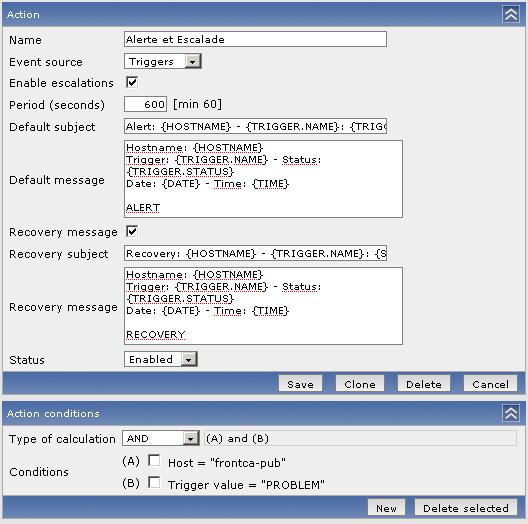

    I've configured an action with escalation enabled, attached to a host.
    After having some trouble at first (mail flood as another zabbix user reported), escalation is working fine.

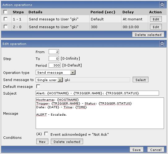

    I've got a first alert message, then (10 mins later) there's escalation with email notification (custom msg) every 5 mins unless acknowledged.

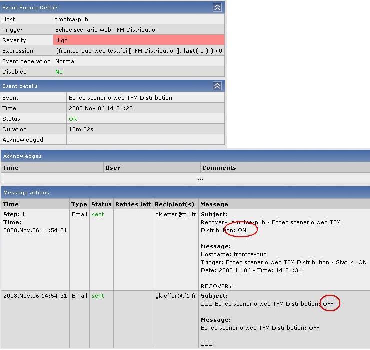

    The only problem is that the recovery message has trigger status = on instead of 'off'

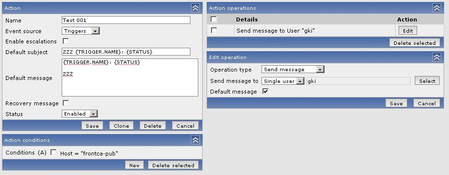

    I've then configured a simple action without escalation, for the same host.
    I get emails for problems/recovery through that action and status is fine: ON when trigger detects a problem, OFF when problem is recovered.
    Another "interesting" aspect is that with the simple action, although I check "Recovery message" and specify a custom recovery message, default message is send for recovery too. (In the provided screenshots I didn't use custom recovery msg for simple action because I discovered the "custom recovery msg" issue only later).
    action_esc_0.JPG : main configuration of action with escalation

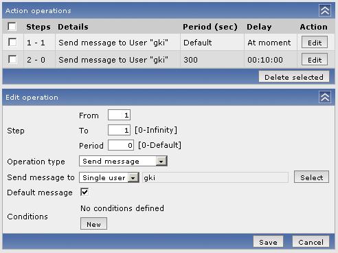

    action_esc_1.JPG : first notification step
    action_esc_2.JPG : second notification step
    action_noesc.JPG : simple action (without custom recovery msg)
    event_recovery_msg.JPG : event log that shows {TRIGGER.STATUS} inconsistency
    Anyone has experienced such behavior ?

        - send immediate notification (Step 1 to 1, default period, send default message to target)
        - after 10 minutes, send notification every 5 minutes with custom message, unless acknlowedged or trigger goes back to OK. I've tried: Step 2-0 (infinity), 300sec delay, send custom message to target, condition: Event acknowledged = "Not Ack")

            You may go straight to pre-1.6.2 available from www.zabbix.com/developers.php. It has the wrong {STATUS} value fixed.
