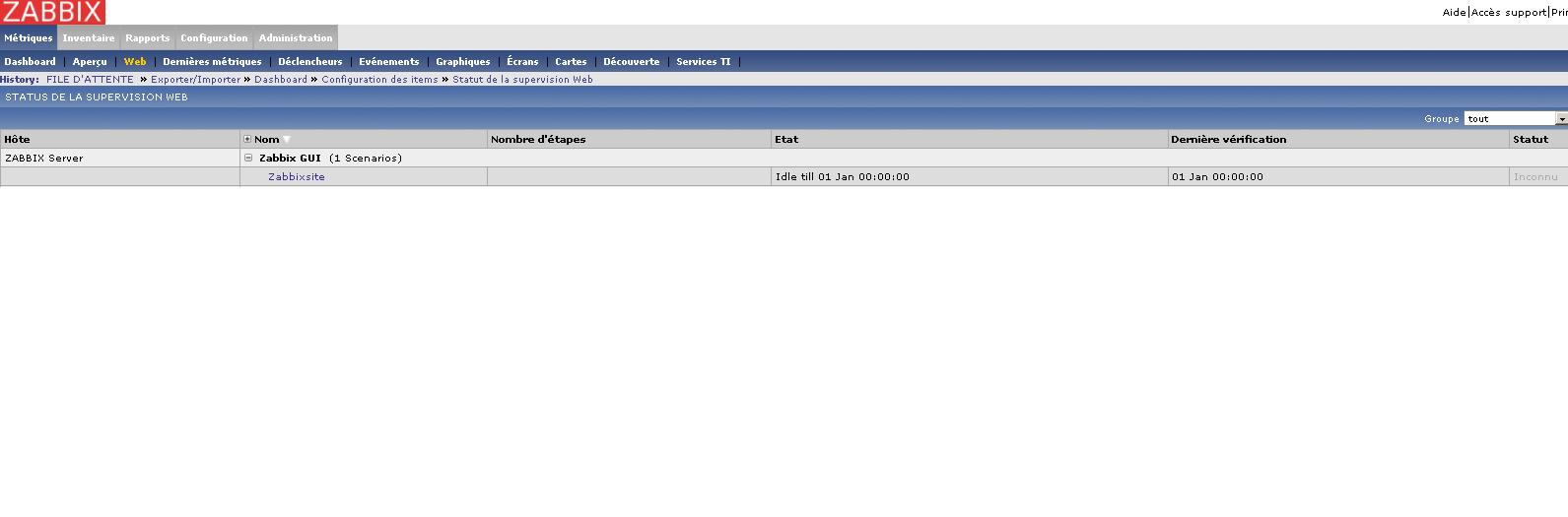

    Now that everything is configured, I would like to create Web scenario to be sure that my Web applications are UP.
    I so tried to configure it, but i always have the screen attached (unknown status).

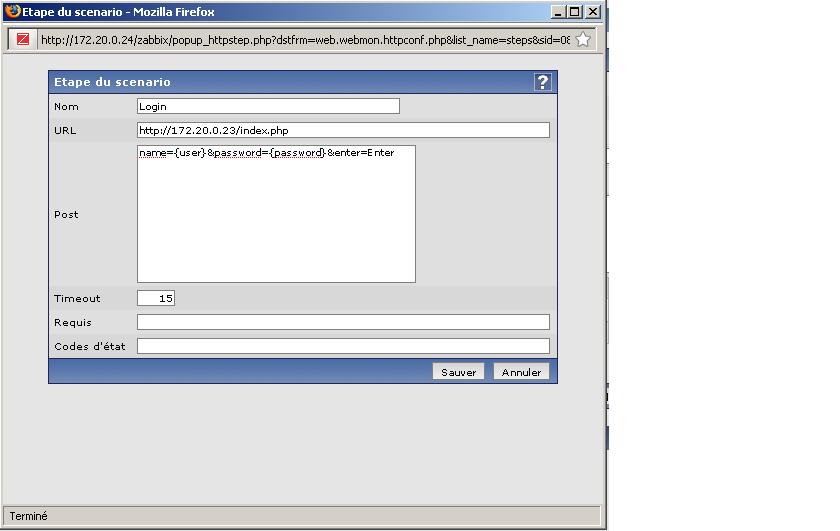

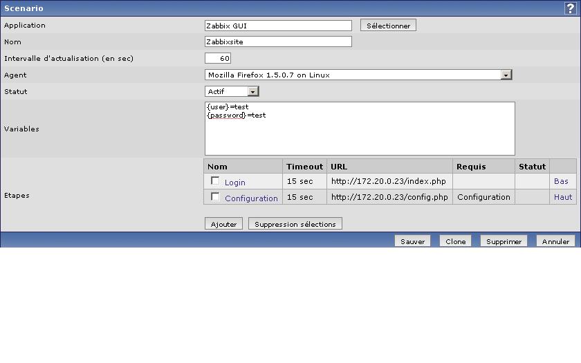

      I have different web applications that I would like to test. I followed the documentation procedure to first try with zabbix interface.
      To verify that it works, i used a special user (with read only rights) that would just be used by the zabbix Web monitoring. But i can't see this user logon in the log of zabbix. Apparently, Zabbix doesn't really log into the web interface. So I would like to know: How can i make zabbix click on the submit button to log in the Zabbix Web interface?
      here is the scenario (using the test user) and the step one details of the scenario.
      Thanks in advance for your help.

        You should always test your "advanced" (POST, ...) checks with curl before implementing them as web scenarios. It makes debugging easier as you see what zabbix will get.
        Here's the command line I used to successfully log into zabbix:
        curl -v \
        --data 'form=1&form_refresh=1&name=monitoring&password=monitoring&enter=Enter' \
        'http://myzabbix.com/index.php?login=1'
        name and password must be urlencoded if they contain non-alphanumeric characters.

        We see that return code is 200 and there's the "window.location" string in case of success.
        So here's how I configured the "Login" step:
        URL: [url]http://myzabbix.com/index.php?login=1[/url]
        Post: form=1&form_refresh=1&name=monitoring&password=monitoring&enter=Enter
        Timeout: 15
        Required: window.location
        Status code: 200
        As far as I know, there's currently no cookie support in zabbix' web monitoring so I think you won't be able to go past the login screen. Maybe in the future zabbix will use libcurl's "cookie jar" to have cookies persist over steps.
