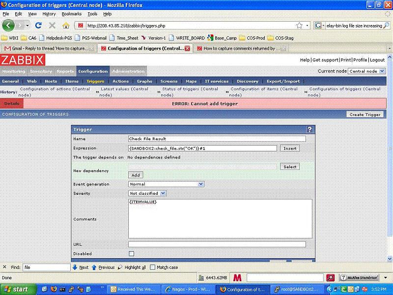

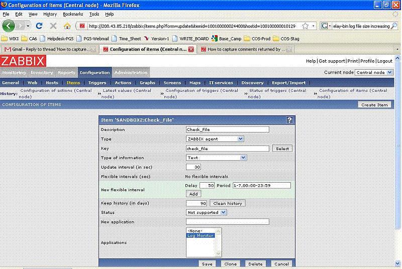

              • ashuji
                • Dec 2008
                • 35
                Does not work
                Hi
                I created following script and ITEM but zabbix showing item "Not Supported":
                [root@SANDBOX2 scripts]# cat /etc/zabbix/bin/check_file.sh
                A="`cat /tmp/test.log`"
                if [ $? == 0 ]
                then
                RET_VAL=OK
                else
                RET_VAL=$A
                fi
                echo $RET_VAL
                [root@SANDBOX2 scripts]# zabbix_agent -t check_file
                check_file [t|OK]
                Item and Trigger configuration in the images attached with this thread. Item was configured but became unsupported, tried to create trigger as suggested but it failed to save. Kindly have a look and suggest solultion.
                Regards
                Ashwani jain
                • trikke
                  • Aug 2007
                  • 140
                  Hi Try:
                  ....str(OK)}#1 -> No "
                  To get more info on your ERROR, just click the Red-ERROR "BOX"!
                  Greets
                  Patrick
                  • ashuji
                    • Dec 2008
                    • 35
                    Whats problem with ITEM
                    Thank, I'll try this new formula in TRIGGER but whats problem with the ITEM, the ITEM i configured is shown 'not supported' in zabbix. If I check the KEY on monitored host using 'zabbix_agent -t check_file' it returns OK. Screen shot of config. of ITEM i had attached with the reply.
                    Please check the ITEM config and suggest why is it shown 'not supported' in zabbix ui.
                    Thanks & regards
                    Ashwani Jain
                    • trikke
                      • Aug 2007
                      • 140
                      OK,
                      first to get a feeling what the Server will receive, try folowing command from the Server: "zabbix_get -s SANDBOX2 -k check_file" as this is the "command" the Server does against the agent ( Agent side seem ok as you checked with agent -t ...)
                      Then just change your item from not supported to aktiv.
                      Check your zabbix_server.log file for possible error messages, check your zabbix_agentd.log file on the agent for possible errors.
                      this should bring u further.
                      As a last thing set your agent to debug=4, restart agent and again check agent logfile for errors or whatever.
                      By the way, how did u embeded the script in the aganets conf??
                      Why don't u just use an item with: system.run[/etc/zabbix/bin/check_file.sh] and leave the Agent "virgin"?

                      • ashuji
                        • Dec 2008
                        • 35
                        Tried, strange behaviour
                        First I checked the agent config on SANDBOX2:
                        [root@SANDBOX2 ~]# tail -n1 /etc/zabbix/zabbix_agent.conf
                        UserParameter=check_file,/etc/zabbix/bin/check_file.sh
                        Now check if the key is working:
                        [root@SANDBOX2 ~]# zabbix_agent -t check_file
                        check_file [t|OK]
                        Check the IP of this monitored host:
                        [root@SANDBOX2 ~]# ifconfig | grep 192
                        inet addr:192.168.90.243 Bcast:192.168.90.255 Mask:255.255.255.0
                        Now checked from Zabbix server:
                        [root@zabbix1 ~]# zabbix_get -s 192.168.90.243 -k check_file
                        ZBX_NOTSUPPORTED
                        See the strange behaviour, on monitored host if we check the key using "zabbix_agent -t <key" the key return desired result. But if we check the same key from Zabbix server using "zabbix_get" it says not supported.
                        Regards
                        Ashwani Jain
