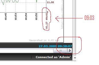

      However, Custom screens, at least for me, do not keep up with current time.
      The screen in the pic is updated every 60 seconds, but the graph does not move along with current time.

        For me it works and refreshes normally..
        I have custom screen with four graphs, and all are updated with every refresh.
