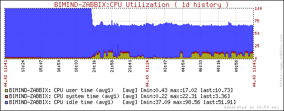

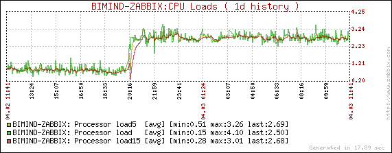

          • bimind
            • Sep 2008
            • 25
            I have the same problem.
            After the update from 1.6.2 to 1.6.3 CPU load and CPU utilization have increased in my zabbix
            I updated the binaries and frontend.
            Thanks,
            Oriol
            • bimind
              • Sep 2008
              • 25
              The CPU graph after upgrade
