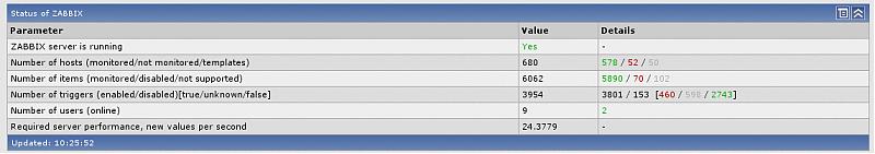

    When my Zabbix reached ~650 hosts (mostly cable modems with 5-10 items) strange problem appear with items update interval.
    Instead of getting item data once a 60s (modems signal level) or once a 10s (e.q. server's CPU load ) it has the data with 20-30 minutes interval.

    Zabbix status (from dashboard) attached.
