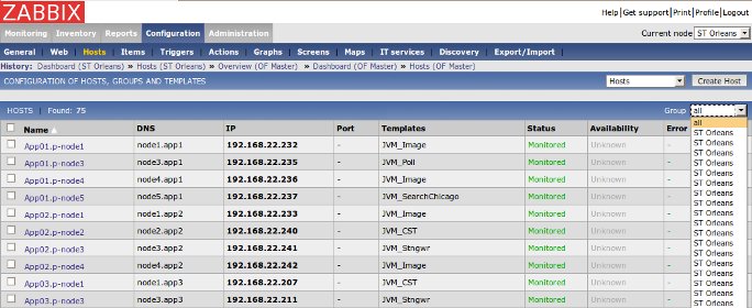

    On the master server web interface:
    1) (proxy) configuration >> Hosts >> group drop down, all the group names are the same (proxy name). I am not sure if this is a side effect of me importing the xml file from the standalone instance. Btw, under host groups, I have unique names for each host group.
    1) Not sure what version you are using, but there were a few web interface bugs in 1.6.4. Download the latest build to get the updated frontend.

        2.) not sure what you mean by "I was adding all the monitors at a proxy level in the master web interface"
        3.) I think you are confusing Proxy and Nodes, because only Nodes appear in the drop down, not proxies. Check under administration -> nodes and make sure your proxy is not listed there. Proxies are added under Configuration -> Hosts -> Proxies
