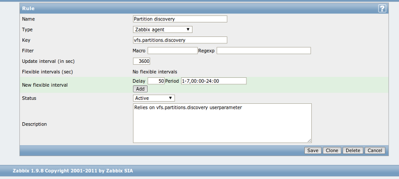

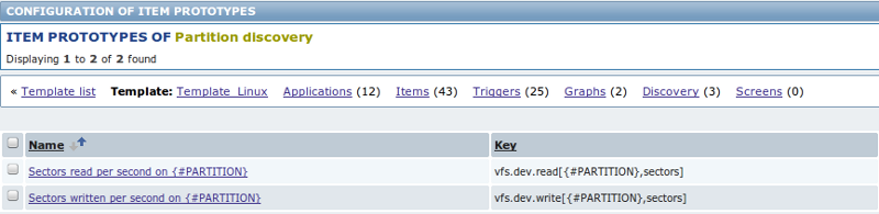

                  the way i understand it vfs.fs.discovery and net.if.discovery are included in zabbix 2 out of the box (built into the zabbix agent). So if i want to discover partitions i would create a new rule with key vfs.partitions.discovery (just like what was created on the zabbix 1.9.8 appliance i downloaded). In the first screenshot (attached) in the description it says that vfs.partitions.discovery relies on userparameter. I checked the zabbix_agentd.conf and do not see any entries for any user defined parameters. Where is it?
                  I also do not understand what i'm seeing in the second screenshot i attached. In the zabbix appliance i do not see this macro {#PARTITION} defined anywhere.

                    my mistake... zabbix_agentd.conf includes folder to userparameters
